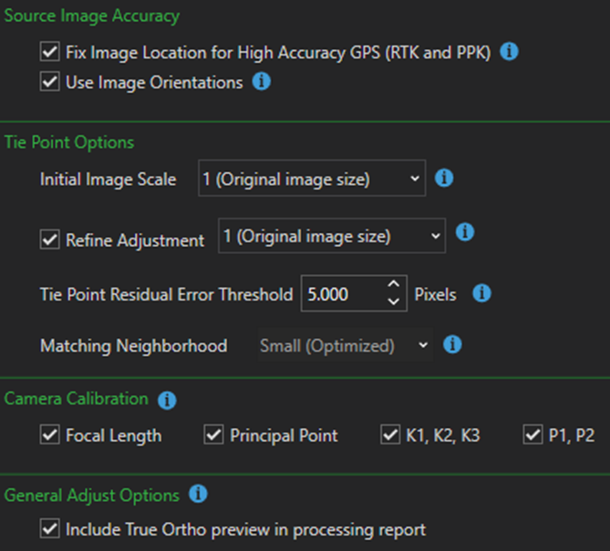

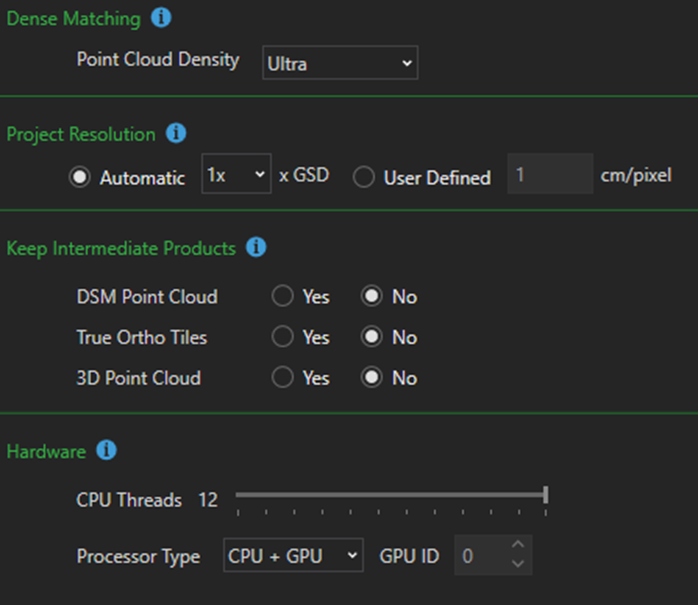

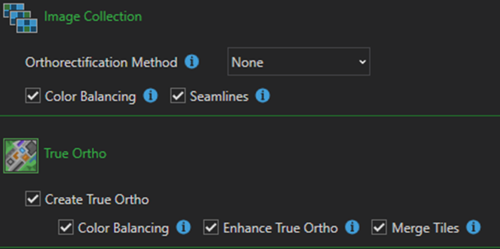

I’ve tried everything and I am pretty sure the problem is on my end, as the good folks at Esri were able to create a stunning ortho with the same dataset and parameters as me. I am using the latest version available for Drone2Map, and this is when the problems started regarding processing Orthomosaics. Unfortunately I don’t get an error code, just a ‘this program stopped unexpectedly, do you want to send an error report?’ message.

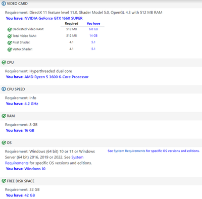

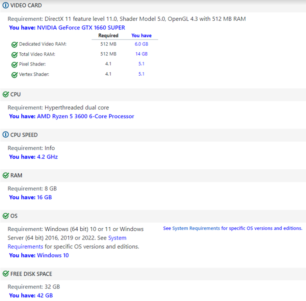

 I don’t think it is any performance issues, my rig meets the minimum requirements as follows:
I have enough space on my disk drive and am saving everything locally. It’s a big site (~ 235 ha) and required around 1,400 images taken. I’ve tried to keep an eye on my memory when Drone2Map is processing the ortho, but it takes a very long time with data of this size, so I am often out of work when it crashes. I have noticed that the memory does spike at times, but I haven’t seen it hit 100% - it floats between 60%-80% most of the time. I should note that Drone2Map works perfectly well with smaller projects/sites and produces fine orthos, and was able to produce a DSM for this particular project without issue. It just seems to be with larger projects and specifically producing orthomosaics for them. Prior to the latest update Drone2Map would not crash, but also would not produce great orthos so I am apprehensive to go back to an older version of the program.

From the description of the issues that you have been seeing and the system specifications that you shared, we believe that the issue is likely related to not having enough free space on the drive you are attempting to process this project on. 1400 images at the Ultra point cloud setting can create very large intermediate datasets. If you are curious on just how large you can enable any of the intermediate products within the Options>General>Keep Intermediate Products, and assuming you have the space they will be created within the project folder.
While your computers hardware specifications are perfectly adequate for running Drone2Map and processing projects, your storage is not. What you are seeing in that "Can you Run it" read out is only accounting for the actual installation and operation of Drone2Map, not the storage cost for projects. Projects with a large number of images that are processed at the highest quality are naturally going to take up more space. This is particularly the case when the project is processing as its having to create those intermediate datasets, which it then deletes unless otherwise selected in Options.

Once I saw the memory getting chokka I cleared adequate drive space because I figured Drone2Map was dumping onto the drive. So I've already tried this to no avail.  The screenshot I attached was a bit misleading in that respect - I have over 250GB of free disk space and the crash still occurs. Surely Drone2Map doesn't need more than 250GB to produce an image. I have run this particular dataset on the older version of Drone2Map at the highest quality with the same disk space and no crashing occurred.

As for Drone2Map processing the full datatset I would drop the Point Cloud Density to High. The True Ortho ouput from SURE engine should still provide the result your looking for.
