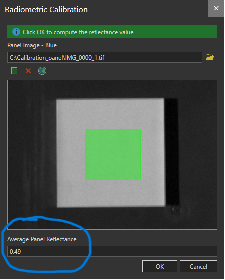

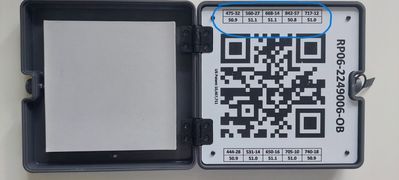

For radiometric calibration of the images from my Micasense RedEdge-P, I want to use the calibration panel of the camera itself. In the calibration panel itself, a table appears with values corresponding to each of the camera bands, as shown in the following photograph.
Are these the values that must be entered directly in the "AVERAGE PANEL REFLECTANCE" field for each band?
Do we have to make some type of unit change in these values?

Yes these are the values you enter for reflectance in the Drone2Map UI.  There are no units - these figures represent the % reflectance, so pure black would be 0, pure white ~0.99 , and mid gray should be near 50% = 0.50
