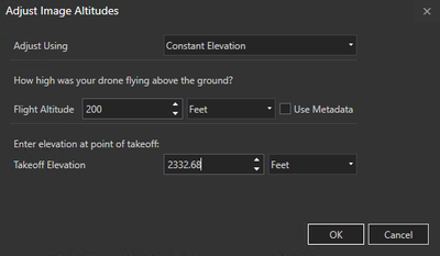

MarkBuie
Status changed to: Implemented
At Drone2Map 2.x you can now adjust Image altitudes using a constant elevation.
Have a look at the Adjust Images Altitude documentation for more information.
