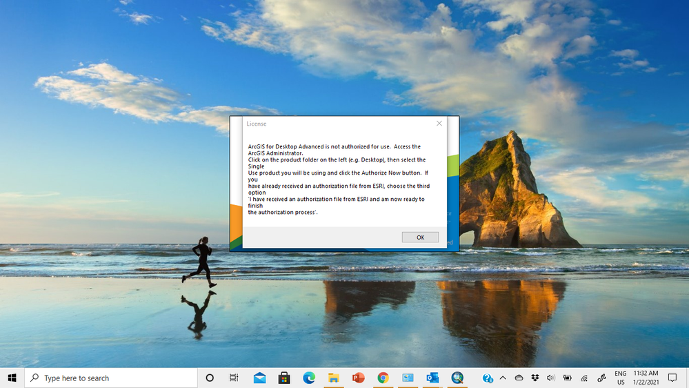

Successful authorization but access to ARCMAP denied

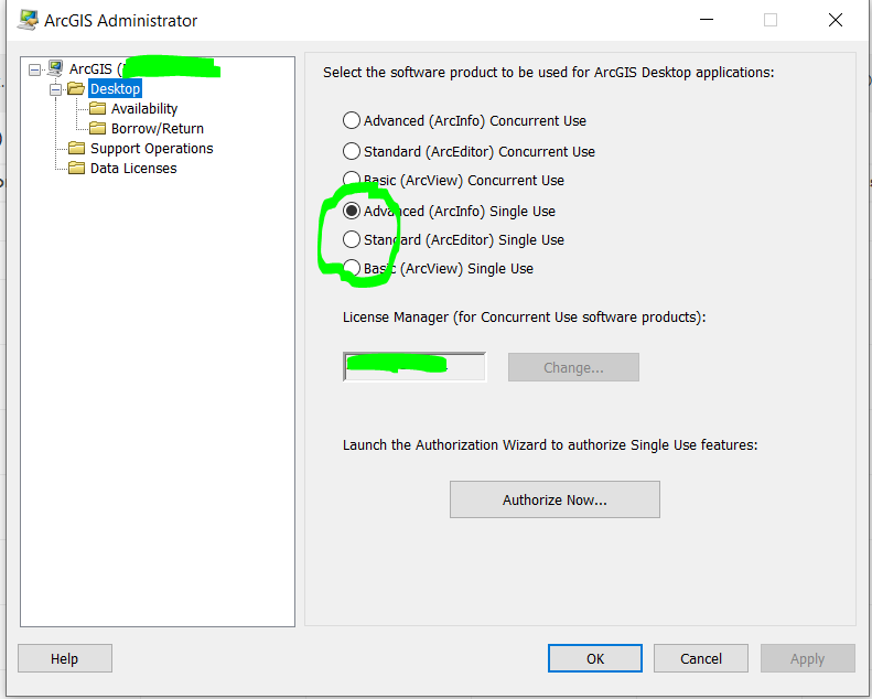

Hi,
Open the ArCGIS Administrator and check whether the right license is selected in the list.
By default the License is on Advanced Concurrent unless you change that.
Remember that, in order to switch the license type you have to access as Admin (but you can view as any user).
If you already authorized, this is enough and you ArcMap will work as soon as you switch.
PanGIS
Sorry, I did not see the text that is formatted as label instead of body.
If you go to Availability, do you see the licenses as authorized?
OluwatuyiOlowoyeye
Thank you @PanGIS  I had to install from offline and it worked perfectly.
