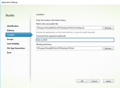

JohnFundersol
When you try to publish an MXD on Citrix you need to use the installation directory of ArcMap.exe as the executable location and then in the command line section you put the path to the MXD file you want to use like show below.
