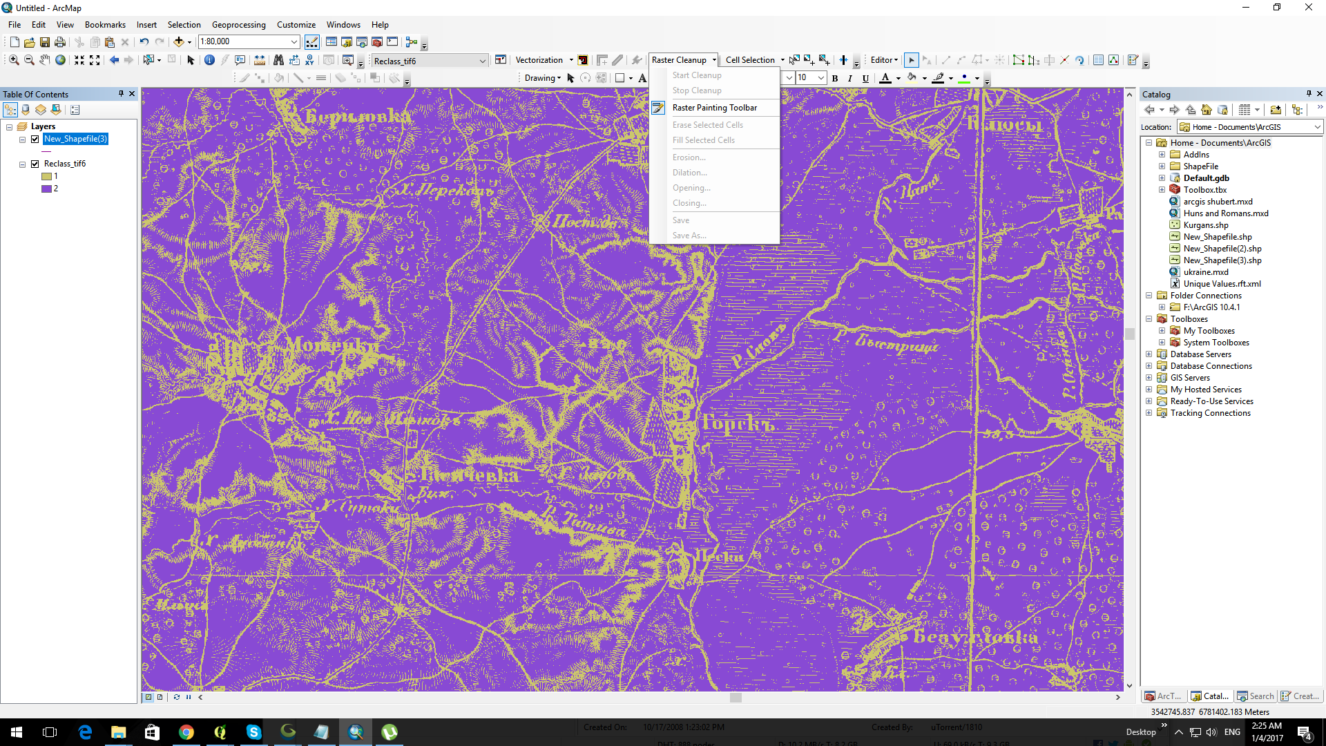

I cannot get raster cleanup buttons to work. Greyed out. Nothing worked.

RomanPilip
Deactivated User
Thank you for your reply.
ArcScan is enabled.
I generates vector, but I cannot clean raster to make it nicer. Raster is in TIFF, and not in database. Raster cleaner picks up proper preview of selected features, but the button erase selected cells is grayed out, as well as button Start cleanup. One more problem happened when I upgraded to 10.4.1 version, classify button is not working. It clicks, but not doing anything. 10.3 version doing fine with the same TIFF.

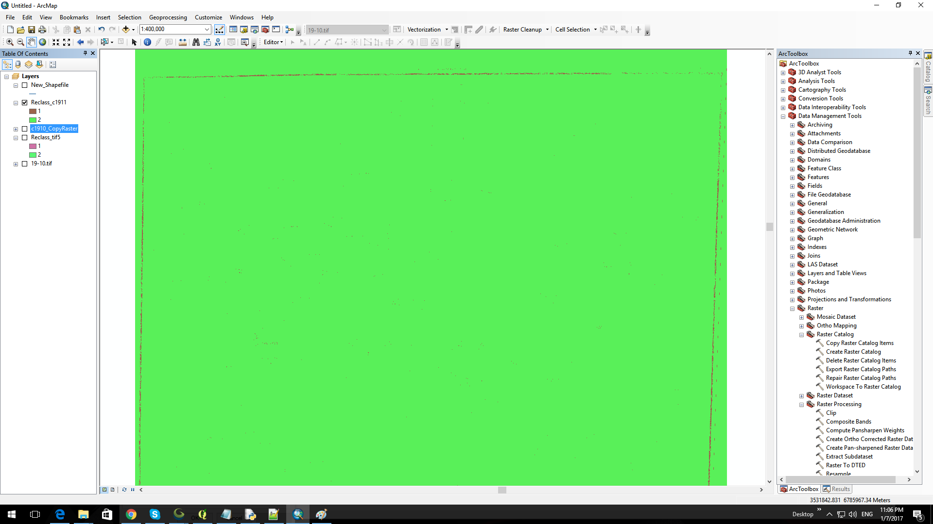

Did you use Copy Raster GP tool as suggested above?
Also try installing the ArcGIS 10.4.1 for (Desktop, Engine, Server) Raster Patch

RomanPilip
Deactivated User
Does no work< see image below. Also If I reclasyfy image twice I can turn edits, but cleanup does not work. It seems almost that raster is in read mode
