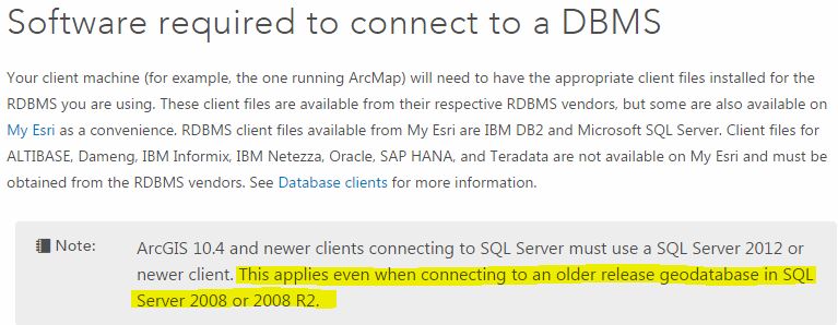

Highlight v10.4 vs. 10.4.1
Editing issues upgrading from 10.3.1 to v10.4.x prompted this upgrade workflow:
  • Upgrade SQL Server from 2008 R2 to 2014 SP 2
  • ArcGIS Desktop 10.3.x and 10.4 clients
    Continue using the Microsoft SQL Server Native Client 2012
    Or, if they have trouble connecting
    Need to install the Microsoft ODBC Driver v11
  • ArcGIS Desktop 10.4.1 clients
    Need to install the Microsoft ODBC Driver v13
