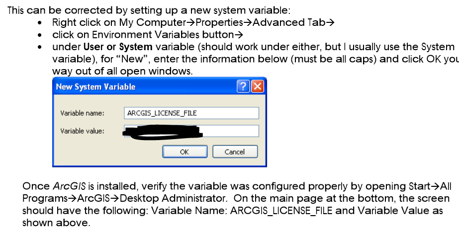

Another possibility, which I have users that are having issues, especially on new machines (even when the "not set" has been corrected to IP), is to set the system variable. Below are the instructions I provide my users for updating the license manager variable.  This was written for XP/Win7, so may be a little different to access My Computer if using a different OS.   We typically enter the IP for the variable.
A reboot with any of this of course never hurts.
