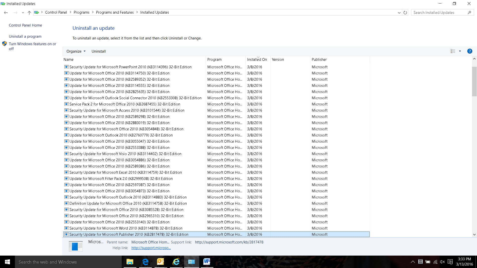

Makes sense. Here are two screen shots of all of the Windows updates that installed on 3/8/2016. How am I supposed to figure out which one caused the problem? There are two screenshots.
Let me know what you think.
Thanks.
Matt

Also found a security update. See screenshot.

Matt,  check to see if you have an update for Python 2.7.11 that was pushed out last December.  This was logged as BUG-000092928 in our system, Python has been notified and they have logged Issue 25824: 32-bit 2.7.11 installer creates registry keys that are incompatible with the installed ...  with their highest severity.  The workaround is to uninstall this update.  Please try this and let us know if this resolves your issue.  Margaret Maher, Esri Support
MattBrowder
Deactivated User
That wasn't it. We had to create all new registry entries in the system and rename a bunch of folders. We eventually fixed it after a few weeks.
