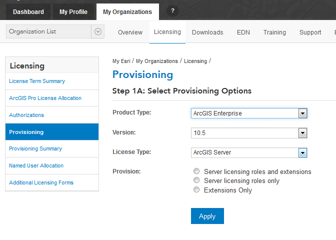

Install ArcGIS Server on one machine—Installation Guides (10.5) | ArcGIS Enterprise
Obtaining an authorization file—Installation Guides (10.5) | ArcGIS Enterprise
You will need to create a Provisioning file using your myesri account for 10.5 Final.  The pre-release one will not work.  It's also called "ArcGIS Enterprise" now, but if you select the ArcGIS Server in the Product type, it will tell you that.

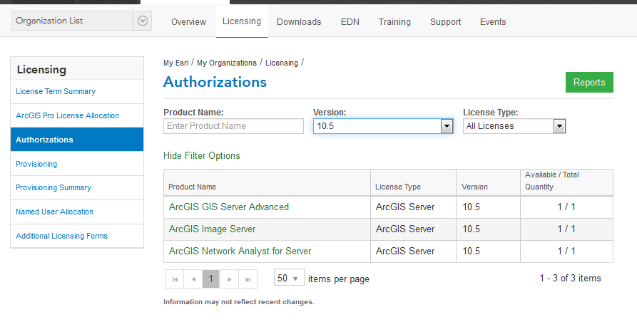

If you look in the Authorizations, you might see something like this when looking for the later version (use the filter)
And yes, you did need to uninstall pre-release before installing the final (that was mentioned somewhere in the pre-release docs).
JohnLadd
I can't create a Provisioning file, presumably, because I have no available Licenses according to my Authorization list.
Probably that is why the Software Authorization Wizard failed after my attempt to install 10.5 final.  Somehow I need to have ESRI acknowledge that I used licenses to install 10.5 prerelease for single use and, apparently, need new licenses to install 10.5 final.  Of course, all this may be unnecessary if there are no significant changes from prerelease to final release.
