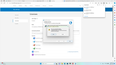

Recently I bought a new laptop and its system passes the recommended requirements.
During installation of ArcGIS Pro, however, an error message appears like the below.
"Verify that the file exists and that you can access it". I am a subscriber, I am supposed to be able to access it. Is there anyone who has an idea or solution for me please?
SaraJL
@BonghiJu I found this post from a while back! It looks like the issue might be One Drive
https://community.esri.com/t5/arcgis-pro-questions/error-1311-when-installing-arcgis-pro/td-p/128418...
I would say try running it from a different location! Like a creating a temp folder on your computer or running it directly from the Downloads folder and see if that helps.
Good luck!
BonghiJu
New Explorer
Thanks a lot, the problem has been solved.
