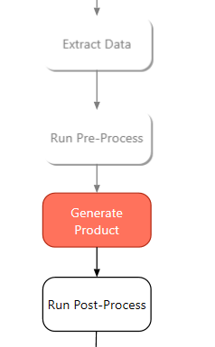

I am currently working on automated cartography using defense & production mapping.  I could successfully generate a pdf file using the default pagx file (TM50_Layout.pagx) found in Product Files.
However, I'd like to make some modifications on that pagx file and make my own pdf which fits to specific qualifications. They'll be some changes in layers name and symbols.
I have already added some new symbols in TM.stylx and checked that the modified pagx loads those symbols very well. The only thing left is to implement that modified pagx file into the EPM using workflow manager. I set the file name as TM50_Layout.pagx as it has to be and run the SAMPLE CARTOGRAPHY AUTOMATED task group.
When it reached the generate product layout step, it stopped. I was trying to run both the Generate Product Layout for Job tool and Generate Product Layout tool, and got the same Error 999999 messages.
I am wondering that the defense mapping does not allow users to use their own pagx files or it is just the error. If anyone knows the answer, please let me know.
Thank you!

I ran the Cartography - Automated workflow again in the workflow manager (classic) in ArcGIS Pro, and it still had the same issue - just stop at the step of Generate Product.
