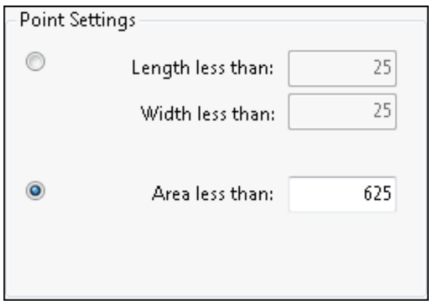

I want to use the point settings for making the areas larger than specific extent to points.

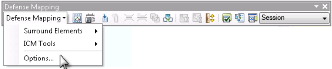

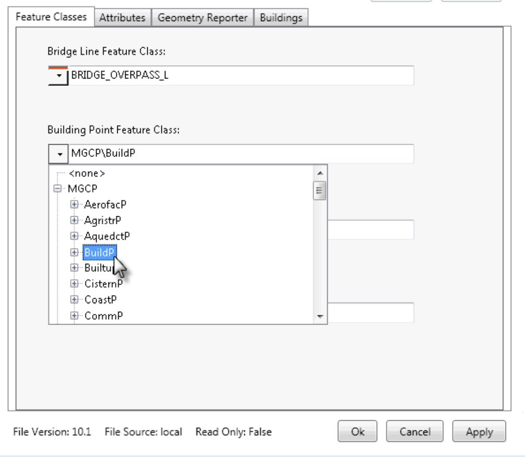

I used to do this in ArcMap by
1. Defense Mapping Toolbar > Options
2. Property Configuration > Feature Classes > Building Point Feature Class
3. Point Settings > Area less than ...
How can I do this in ArcGIS Pro?
