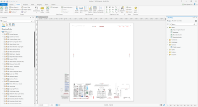

Predefined map documents in ArcMap have been migrated to ArcGIS Pro layout files.
MTM50_TRD_4_X.mxd -> MTM50_layout.pagx
MTM100_TRD_4_X.mxd -> MTM100_layout.pagx
TM25_TDS_7.mxd -> TM25_layout.pagx
TM50_TDS_7.mxd -> TM50_layout.pagx
TM100_TDS_7.mxd -> TM100_layout.pagx
These layout files contain surround information, map frames, layers, symbology, labeling, and elements needed to create MGCP and TDS standard specification maps.

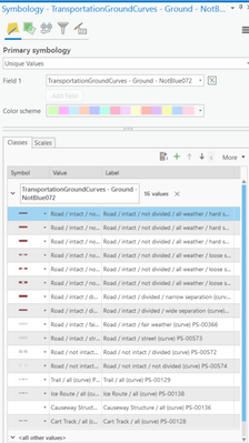

Symbology
Symbolizing maps in ArcGIS Pro has significantly changed by using only standard symbology symbols. Representations are not used in the cartographic process for ArcGIS Pro. ArcGIS Pro only reads representation symbology and does not allow you to edit representations or overrides.
ArcGIS Defense Mapping symbology for MTM and TM map products has been converted to this new standard symbology. The maps in the layout files have also been converted to using this standard symbology along with using Arcade expressions to assign symbols based on attribution. This replaces the ArcMap Visual Specification Table that would apply symbols to feature layers using sql statements.

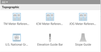

Elements
ArcGIS Defense Mapping has implemented the standard elements that are in the MTM and TM map specifications which are available in the predefined layouts for the MTM and TM specifications that are in the Defense Mapping product files. You can also insert these elements from the Insert ribbon in ArcGIS Pro under the Map Surrounds section.
Elements available from the Insert ribbon include North Arrows, Meter Reference Guides, Slope Guide, Elevation Guide Bar.
North Arrows are in the North Arrow drop down in the topographic section (towards the bottom)
The other specification elements are in the Additional Surrounds drop down.

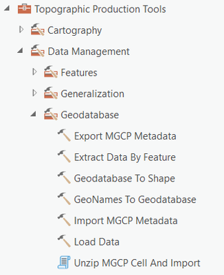

In ArcGIS Pro you will see some differences in the location of tools for ArcGIS Production Mapping and ArcGIS Defense Mapping. Both Production Mapping and Defense Mapping geoprocessing tools are now located in the Topographic Production Toolbox. For more information: https://pro.arcgis.com/en/pro-app/tool-reference/topographic-production/an-overview-of-the-topograph....
Extract Data
In ArcMap, the Extract and Clip Data tool was used to extracting data for Cartographic Product. ArcGIS Pro has a new tool called Extract Data by Feature for extracting data or creating checkout replica of the cartographic product area of interest. For more information: https://pro.arcgis.com/en/pro-app/tool-reference/topographic-production/extract-data-by-feature.htm.
Extract and Clip - > Extract Data by Feature

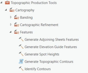

Create Contours
The Create Contours tool is now called Generate Topographic Contours tool and is available in the topographic production toolbox to create and smooth contours from an input raster. For more information: https://pro.arcgis.com/en/pro-app/tool-reference/topographic-production/generate-topographic-contour...
Create Spot Heights
Creating spot heights tools in ArcGIS Pro are the same as the tools in ArcMap, except that the name in Pro has changed to Generate Spot Heights. For more information:  https://pro.arcgis.com/en/pro-app/tool-reference/topographic-production/generate-spot-heights.htm.

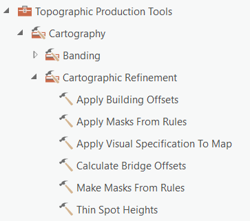

Cartographic Refinement
We have built equivalent cartographic refinement tools in ArcGIS Pro Production Mapping. The following tools are used for cartographic refinement using the OCTS layout template provided in ArcGIS Production Mapping and ArcGIS Defense Mapping. For more information: https://pro.arcgis.com/en/pro-app/tool-reference/topographic-production/populate-map-sheet-info.htm
Apply Building offsets
Aligns, moves, and hides building, or bridge marker symbols based on product specification rules defined in an .xml file.
Calculate Bridge offsets
Calculates the offsets necessary to properly display bridges at a given location.
Thin Spot Heights
Generalizes spot heights for a given area of interest in accordance with product specifications. For more information: https://pro.arcgis.com/en/pro-app/tool-reference/topographic-production/thin-spot-heights.htm
Make Masks from Rules
Creates polygon masks for features based on color rules. For more information: https://pro.arcgis.com/en/pro-app/tool-reference/topographic-production/make-masks-from-rules.htm
Apply Masks from Rules
Applies symbol layer masking to feature layers in a map based on an XML rule file and mask features created by the Make Mask from Rules tool. For more information: https://pro.arcgis.com/en/pro-app/tool-reference/topographic-production/apply-masks-from-rules.htm

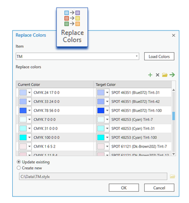

Custom Colors
If you have maps that have colors outside of the MTM or TM color specification ArcGIS Defense Mapping has a tool that can help in mapping these colors.
The Replace colors tool will allow users to replace colors in a map, layout, or style in the catalog view. Use this tool to update color mapping, including specification-driven color changes, in which updates apply to all colors in a product. For more information: https://pro.arcgis.com/en/pro-app/help/production/production-mapping/replace-colors.htm
