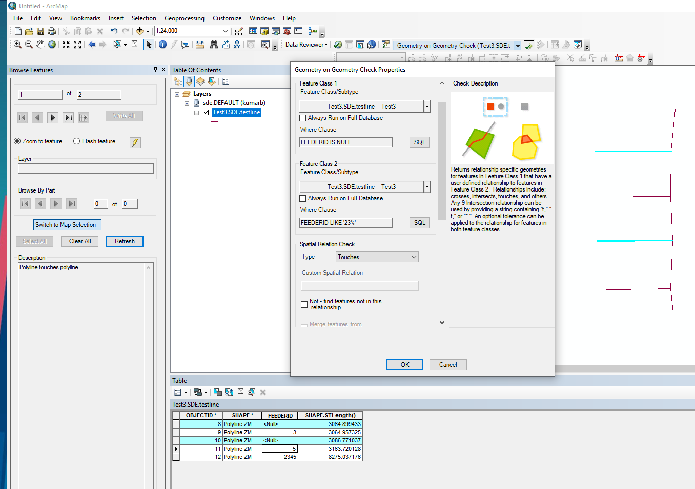

KumarGaurav
Hi Bryce,
I tried similar configuration with my sample data and Geometry on Geometry check with Touches option worked for me:
You can use same configuration in ArcGIS Pro as well.
Hope this helps.
Thanks,
Kumar

brycehoward
Thank you so much! This worked really well besides one thing. When I write them to the table to be corrected, it's writing the line segment with the FEEDERID since it's touching a line segment with a <null>. How can I get it to switch so the <null>  line segment gets written to the table?
Thank you again.
Edit: Just had to switch my definition queries around it worked great. Thank you!
