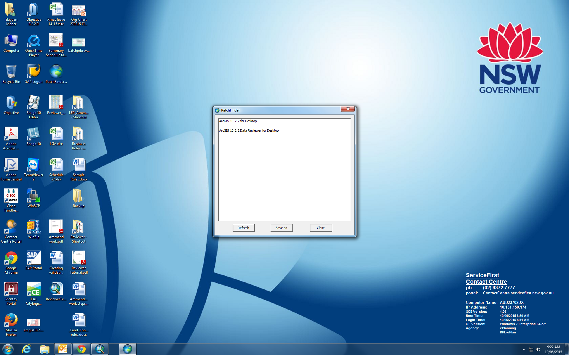

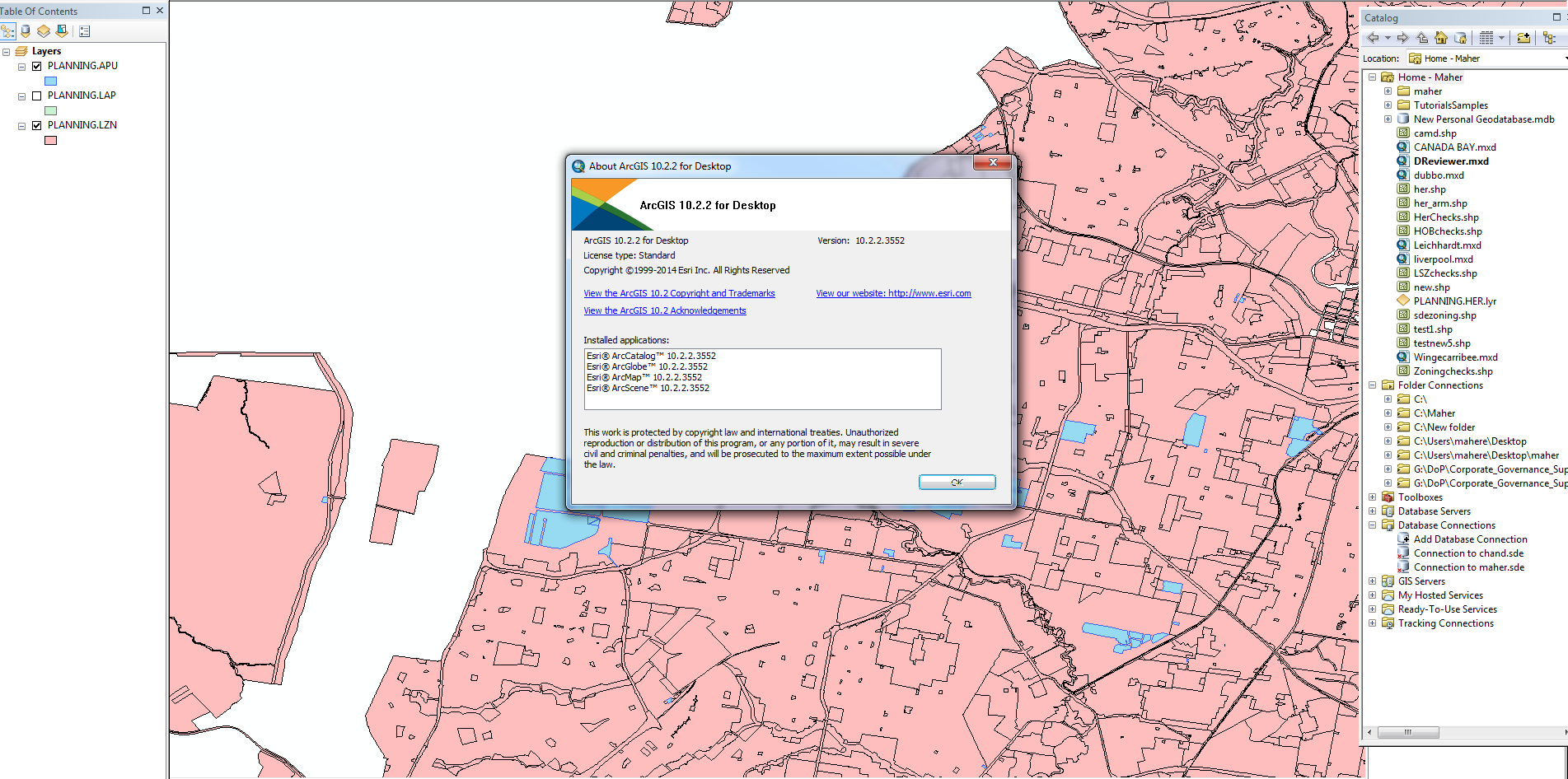

MichelleJohnson
Use the link in my previous reply.  It is to the PatchFinder utility.

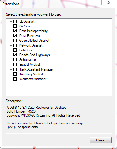

The image just shows me you have ArcGIS Desktop 10.2.2, but does not tell me Data Reviewer version.  If you do not want to use the PatchFinder, then you can go to Customize>Extensions and click on Data Reviewer.

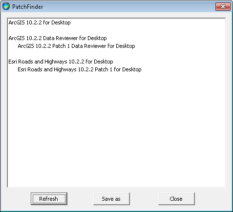

That PatchFinder did not list the patch.  It should have if it was installed.
The patch I pointed you to was released Feb 6, 2014.  It's Data Reviewer 10.2.2 patch 2.
Here's a screenshot of patch finder on my desktop computer.
