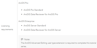

I have published a branch versioned service with the error tables included and Validation checked at publishing. I can Add Error Layers in a map in ArcGIS Pro when editing the published service. When I try evaluating rules I get this error:
Edit operation failed. Message: Operation failed to execute due to license not available. Authorize and enable the Data Reviewer for ArcGIS Server extension to access this functionality
I am assuming that authorizing the Data Reviewer for ArcGIS Server will make the Evaluate Rules button available when editing a version of the service? The user has an ArcGIS Pro Advanced license with an ArcGIS Data Review and Advanced Editing extensions assigned.  Is there anything else I need to check or configure before this works?

@bbaker_tngeo The following should help:
Reference: Set up and publish rules to a feature service
