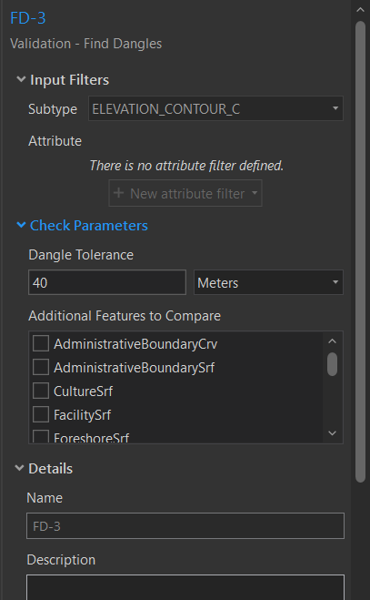

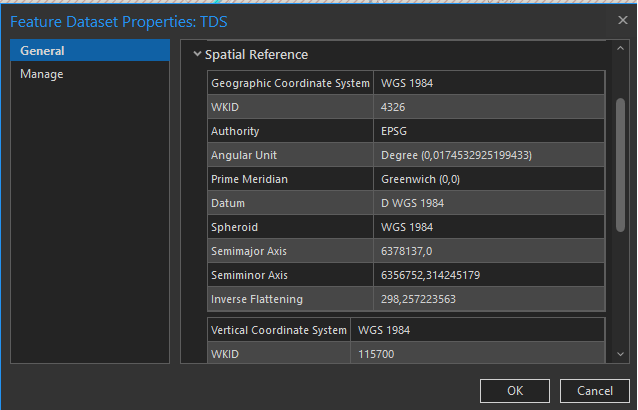

Can you share the details of your configuration? For example, the check settings (input filters, dangle tolerance, dangle tolerance unit of measure, additional features to compare) and spatial reference of the input dataset.
You may want to also verify that the polylines are actually snapped to another feature and do not have micro-gaps.

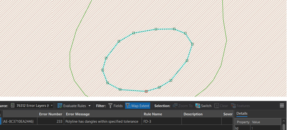

ammsgis
Feature closed but appeared in Error InspectorFeature closed but appeared in Error Inspector
Theoretically, there are no dangles in the feature, however, it is still identified in the rule. I noticed that as you increase the dangle tolerance, the rule starts to pick up more and more features that are already snapped.
If I used the tool wrongly tell me know, please.
Thank you one more time.
Rule parametersRule parametersSpatial ReferenceSpatial Reference
