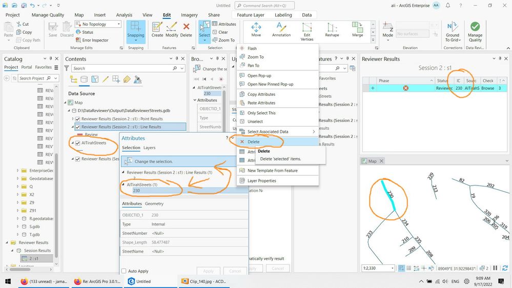

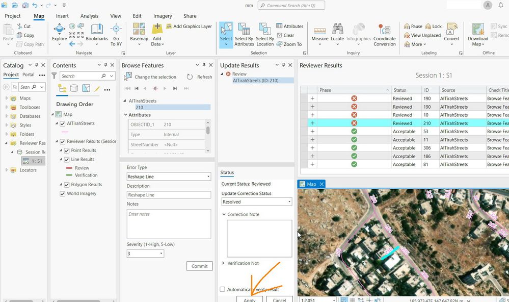

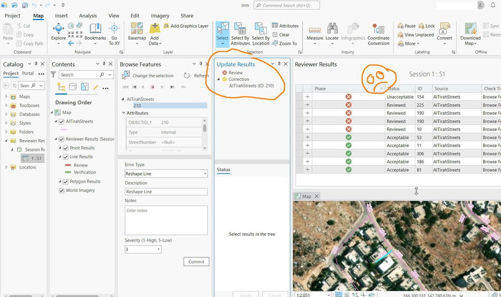

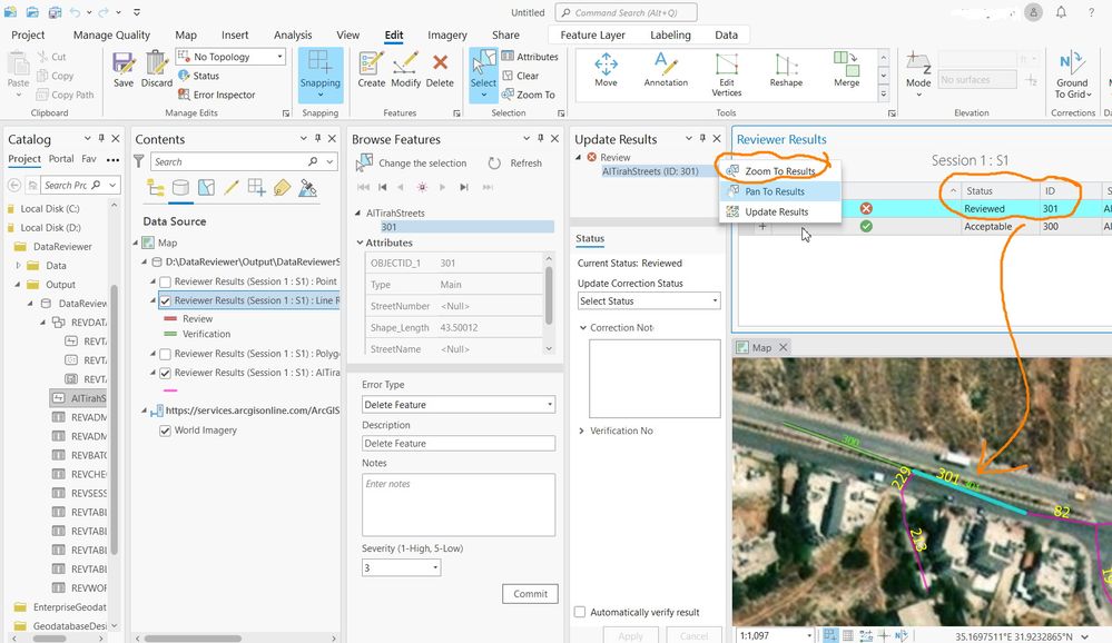

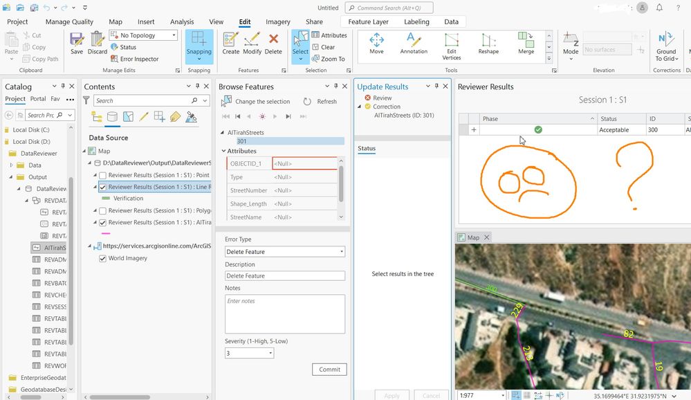

In the screenshots below, the record of feature #210 disappears as it’s updated and marked as “resolved”.
What could be the issue here?
My understanding is the record should be kept in the table in all its life cycle: review, correction, and verification status

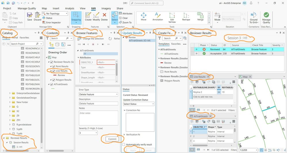

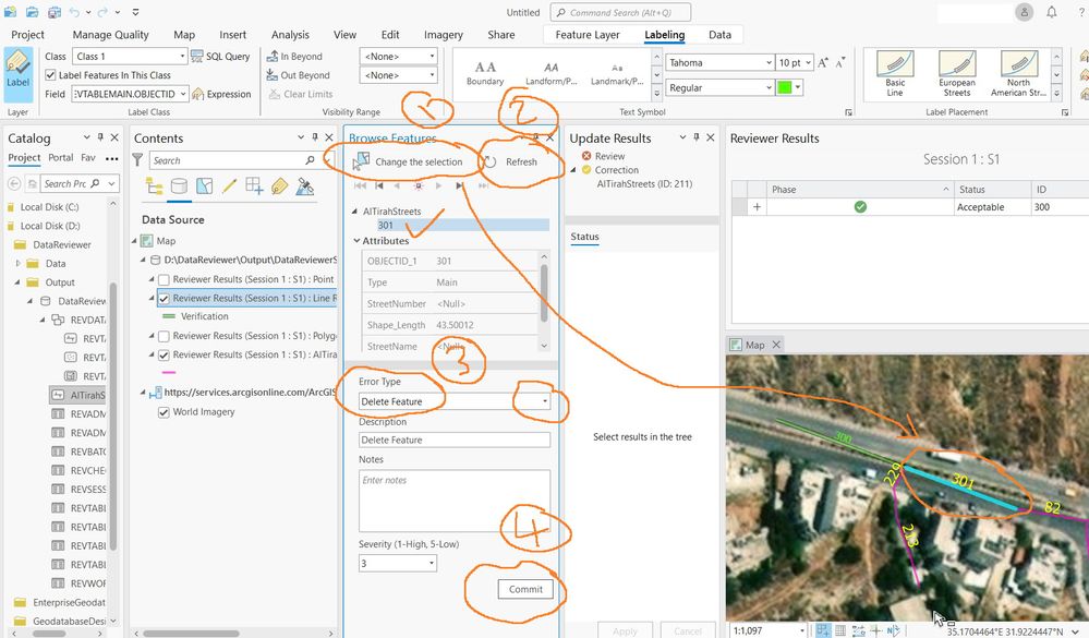

The issue can be reproduced as follows:
  • Select a feature and commit it with “delete feature” as “error type”
  • As the record of this error appears in the review results session table, zoom to it
  • Select the feature that has the error and delete it
  • Go back to the record that represent this error review results session table and update it
  • Once the “apply” is clicked in the “update result” pane, then the record disappears
The screenshots below shows the steps above

Does deleting the feature that has an error gets its record deleted from the reviewer result table?
All what I do is deleting the feature that has an error and then its error gets deleted when performing the update

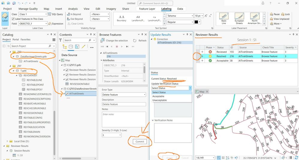

Great. It works like a charm
Enabling the “reviewer results” in a geodatabase different from the one that accommodates the feature classes being handled resolves the issue. This workflow is more appropriate and makes sense.
