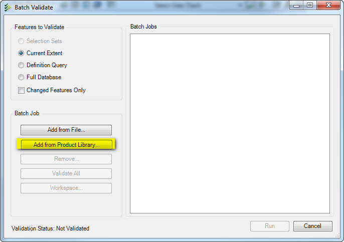

I start a reviewer Session
I define where the jobs are availables

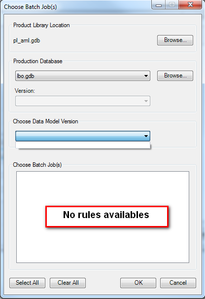

The product library and the production database are defined but I cannot chose a data model and there is no Batch Jobs.

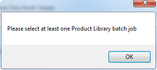

I can't validate with no rule.

CraigGreene
In the Product Library window, right click on your production database and select "Choose Data Model Versions"
Check the LBO checkbox in the Choose Data Model Versions dialog.
You should now see the attribute checks available in the Choose Batch Job(s) dialog and window.
Thanks.
