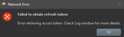

I am following your blog post Creating an FME Web Connection for your Enterprise Portal and am running into at least one issue:
...and in the Translation Log, I find this:
Request to update access token failed. HTTP Error: HTTP/1.1 401 Unauthorized - https://myenterpriseportal.org/portal/sharing/rest/oauth2/token

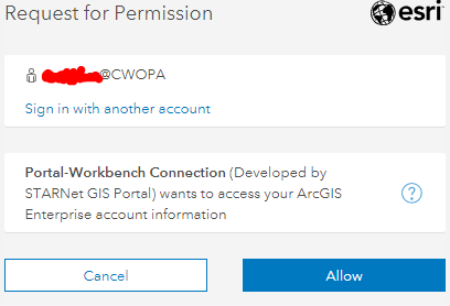

After I enter in my credentials, I get this window...
I have used my login (admin), the login that I want to use (a resource account that is used for the Enterprise admin functionality).  I have tried to enter usernames in 3 different ways - and the above window correctly displays the user name as seen in Portal.
My Portal setup just uses our Active Directory for authentication and I do have the Single Sign-On experience working for our users.  I do not allow anonymous user access and do not allow people to create built-in accounts.  I only assign user seats through Active Directory.
