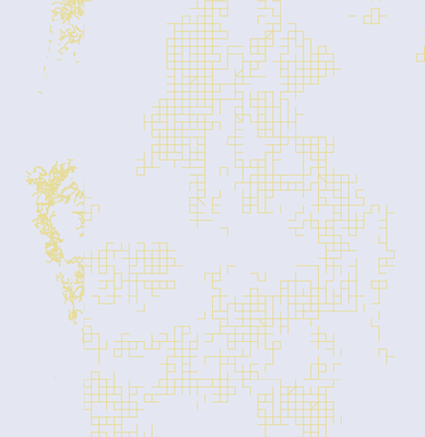

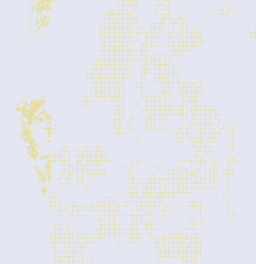

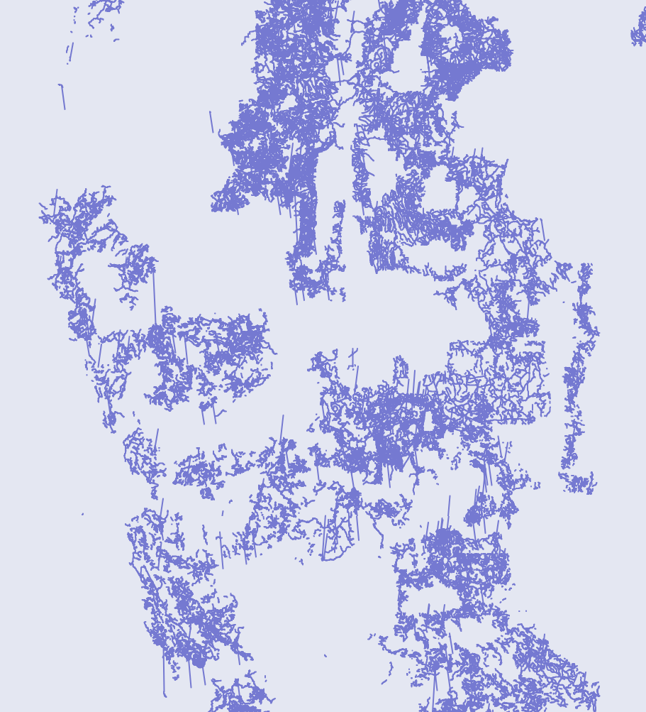

From this point, relevant debug printouts are visible in View Details -> Messages.  Assuming zoom levels of 0-5 and an unfiltered dataset, the tiles would be expected to appear similar to the segment of map in purple (exported via QGIS, which has some small errors in geometry).  Instead, the resulting tiles render as shown in yellow.
