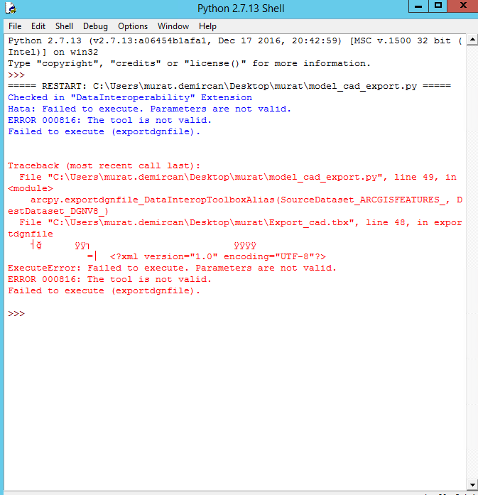

To specify the problem, I exported the model to Python script. I changed the necessary corrections on Python script. But unfortunately, I get the same result. When the function of spatial tool has been started, I get an error.
I searched different solutions for ERROR 000816. But I couldn't get the result from those posts for my situation. And finally, when I run ETL tool in python script, I get the error for parameters with some XML syntax which I don't know where they come from.

Thank you for your comment. But I'm adding python script codes, and it checks that if there is any Data Interoperability license. https://support.esri.com/en/technical-article/000012387 I applied the process and checked the license like in this link. I didn't get any errors when checking the Data Interoperability license by Python code. The error comes when executing ETL toolbox function in the python geoprocessing service. Do you think this is caused by license?

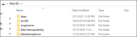

Btw, I have installed ArcGIS Server to "D" named driver of the computer. And I also have installed Data Interop to the same D driver. My problem can be caused by this? How can I see that Data Interoperability for ArcGIS Server is installed successfully?

My installation path seems : "D:\Data Interoperability"

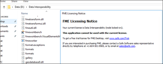

When I try to open fmeworkbench.exe file, FME License is been seen.

Thank you for your suggestions. One of our customers didn't want us to install Esri and FME installations to their C driver. That's why we had to install them to D driver. So, what I understand from you saying, we should change the installation paths (re-install the products) to run our products without any problem. Am I right?

Hi, I don't know if it is a problem the software is installed in a non-standard path, the support people will be able to advise.  Regardless you are unable to start Workbench from the executable so there is something wrong with licensing, fmeworkbench.exe should start.
