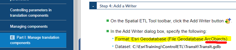

The first problem I run into is with Adding a Writer.  In the Format section, I am told to use this specific format:
formatformat
The only Geodatabase formats available are as follows:
I believe that the correct selection would be the last one.  Not sure, but I am pretty sure.

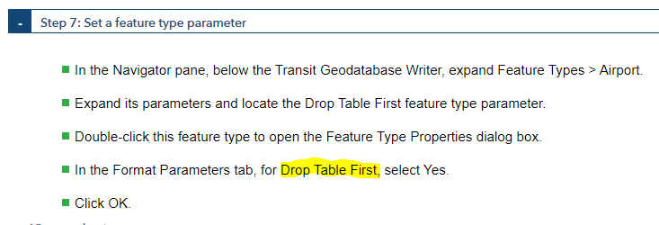

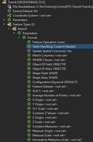

When I look for the Drop Table First parameter, I cannot find it in the Geodatabase Writer that I have created in Pro's FME:

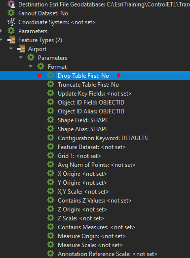

If I open Esri's pre-made ETL tool that should mirror the result of my efforts by the end of the training section - and look at the parameters there, I see this:
So - Esri Training's post-exercise completed example was probably created in Desktop 10.5. - I am using Pro.

Thanks for persevering with our dated training materials, we have transitioned to leveraging Safe Software's courses at present.  For the first part of your question, we renamed the long form of the ArcObjects-based file geodatabase writer to drop the word 'ArcObjects', we thought it didn't add anything.  The short form of the format - GEODATABASE_FILE - is unchanged.  For the second part of your question it is the Table Handling parameter that has the options you are looking for:

The second part - Would "Drop and Create" be my choice for the legacy "Drop Table First"?
Thanks,
--Adam
BruceHarold
Esri Frequent Contributor
Yes that's right.  I almost always use that setting in case my target feature class already exists, it functions like 'drop if exists then create'.
