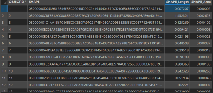

So this is my first time extracting data from MS Access MDB database to an ArcGIS Pro 3.6 geodatabase. I used the Quick Import tool for this purposes. The conversion worked as in the data was extracted as geodatabase tables. However some of these geodatabase tables are actually vector data but Pro does not recognize them during the conversion and instead converts them as geodatabase tables. My question is how can I now convert this for example geodatabase table to a line feature class. It's attributes are as follows
SHAPE has data type Text
SHAPE_Length and SHAPE_Area have data type Double

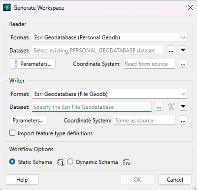

Ed, make sure to use the Esri Geodatabase (Personal Geodb) format in Quick Import, not Microsoft Access.
See also:  https://docs.safe.com/fme/2025.1/html/FME-Form-Documentation/FME-ReadersWriters/personal_geodatabase...

If you come across other issues that prevent you from moving forward with Quick Import, you can also use the Workbench app as a standalone to build that workspace. If you have to repeat the conversion multiple times, you get more flexibility out of the workbench app for potential errors like, projection issues, bad data, renaming attributes, etc.
When using the Workbench app, use the Generate Workspace tool to start that workflow.
