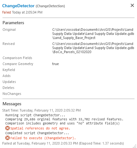

I am trying to get this tool to work but cannot get past this error:
I projected both parcel layers to the same coordinate system so I do not understand how the spatial references do not agree. I am using a trial copy of ArcGIS Pro 2.4.3 because our enterprise agreement does not come with data interoperability extension.

Hi Brett, sorry about the delay responding, I totally missed your comment.
The check throwing the error is coded as a string comparison comparing the two spatial references.
In your Pro session's Python window key in code like below, replacing the inputs with your layer names.
If the spatial references differ you may see where by inspecting the strings.
A good way to force agreement in spatial references is to put both data sets into a feature dataset.

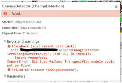

I have both the point layers are in a feature dataset that is in the default File Geodatabase for the project. I have copied the ArcGISProDataInteroperability.pth in the site-packages folder. I am using  ArcGIS Pro version 2.7.1.
I am getting this error when I run the tool with the two point layers and comparing FacilityID field in both the layers.

Hi, please check you have Data Interoperability extension installed and licensed, the import error looks like a missing install or license issue.
As your real goal is to detect changes in a feature service it may be more efficient to use a Spatial ETL tool directly in a model.  If you are able to share some sample data I can show you how that would work.

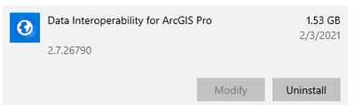

Thanks for the response, I checked the  Data Interoperability extension installation, looks like it is installed
and I can see the extension under the Analysis Tab in ArcGIS pro

I replaced the .pth file with one that expects Python 3.7 in Pro 2.7, please download the zipfile again, your process should work.
SRJS4
Thanks, Bruce, it worked perfectly, got the exact results that I was expecting.

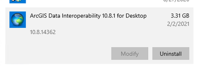

Good to hear, but by the way, your screen shot of 10.8.1 for Desktop above relates to the ArcMap install, but I could see the Pro install was OK as the Analysis ribbon commands are active.
SRJS4
Bruce,
I checked and the ArcGIS pro install looks fine as well.
