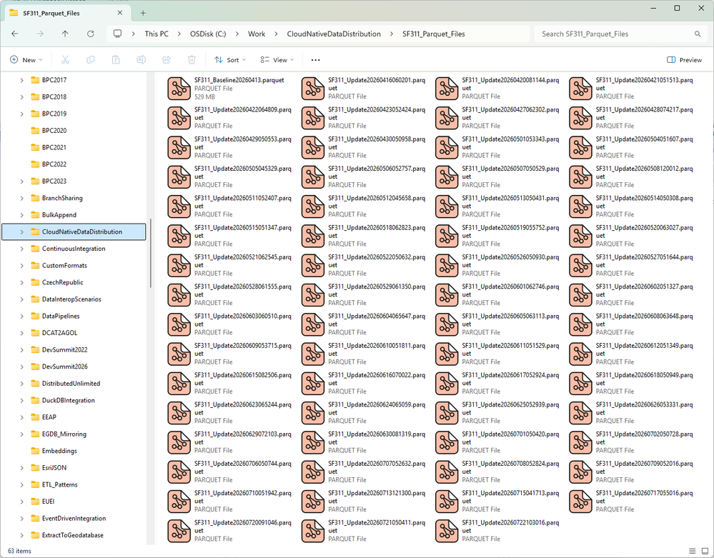

After a couple of months scheduled ETL of GeoParquet files into a folder (in production I would use an S3-API compliant object store) I have 63 files:
ETL OutputETL Output

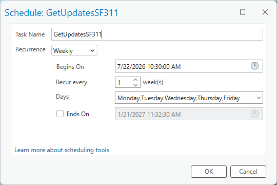

Scheduling ETL Tools
ArcGIS Pro can schedule any geoprocessing tool, as can ArcGIS Enterprise, and ETL tools are no different.  Once scheduled, you don't have to interrupt your other work just to maintain data, and by using recurrence, you take care of future demand as well.  It is also a good way to automate logging your ETL and geoprocessing metadata.
Spoiler
Not shown:  To prevent interruptions to your schedule if you take days off work, use Windows Task Scheduler to allow the task to run if you are not signed in.  By default tasks will not run if you are not signed in.
Here is my schedule dialog, starting today (at writing):
Schedule ETLSchedule ETL

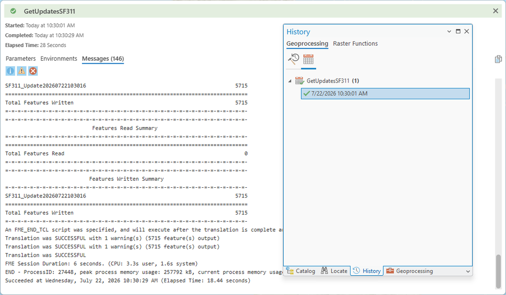

And here, after one scheduled run, we see from the History pane the latest GeoParquet file (with 2 days' worth of 311 transactions) is created in 28 seconds by the scheduled ETL tool:
Schedule HistorySchedule History
So far so good!  How does this perform?

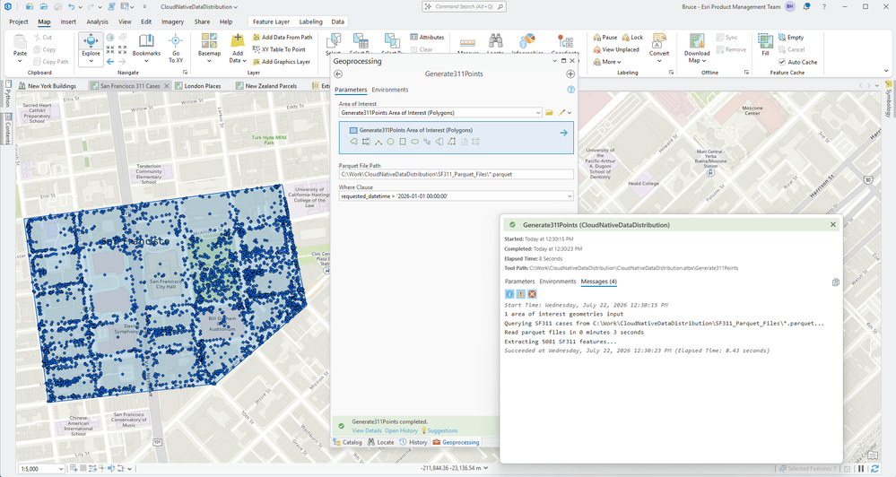

So I have an original 8.7 million points in a baseline GeoParquet file and another roughly 3000 edits per weekday in their own GeoParquet files, how does querying perform?
Using a script tool (see the blog download) that allows setting a query shape and where expression I extract over 5000 case features for this year around City Hall in 8 seconds.
Query ExampleQuery Example
