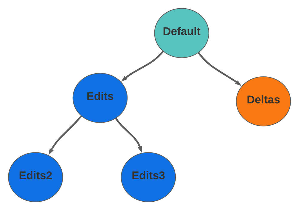

You're going to need a version that is a direct child of Default that you never edit, it doesn't matter what other versions you have but only edits posted to Default will propagate to the mirror.  I call my child version 'Deltas'.  Your initial target system (geodatabase, database or feature service) must be a copy of Default.
Your daily workflow is to get your edits into Default then compare version differences with Deltas.  If you think about it, after a daily edit post Deltas is a view of the database one day before Default.  That means its 'older', or an 'ancestor' of sorts (made my head spin too at first that a child is a logical ancestor but bear with me).

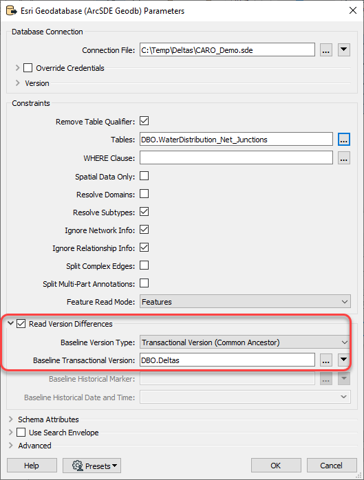

When adding the geodatabase reader to your ETL workspace, set the Read Version Differences property and use a connection to Deltas as the transactional common ancestor.  I know, its weird, but it works.
When the reader executes the features returned will be in the context of edits needed to make Deltas look like Default, and will have a format attribute fme_db_operation set to INSERT, UPDATE or DELETE.

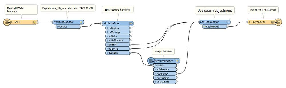

Now all you have to do is apply the differences.  I'll walk you through the sample workspace pictured below.

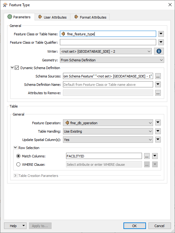

The reader uses the option to merge all selected feature types using a * wildcard.  This lets you use a single reader for the entire set of versioned feature classes - did I mention how powerful this option is?  There is always a format attribute fme_feature_type available to let you see what source feature class anything came from.  The AttributeExposer lets me access fme_db_operation and an attribute FACILITYID, a unique key within each feature type that lets me support update operations.  If you don't have such a key field you will need to handle updates as delete/add pairs which I haven't modeled here.
Inserts and updates can go directly to the target database or feature service but deletes are a bit tricky.  The FeatureReader reads one Deltas feature at a time with a SQL where statement that selects by ObjectID and you must also set the accumulation mode to Merge Initiator and Result to get the attributes from the deleted features onto the feature (they come through as null otherwise - they were deleted!).
Then the data goes to the writer, which has FACILITYID set as the match column.
