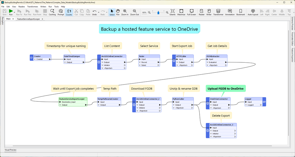

Here is my spatial ETL workspace:
Share File Geodatabase to OneDriveShare File Geodatabase to OneDrive
I'll let you browse the workspace (in the blog download), but what it does is submit an Export job to ArcGIS Online, downloads the resultant zipped file geodatabase item, unzips, renames and then uploads the geodatabase to a folder in OneDrive.  The workspace cleans up the export item as well.  The secret ingredient is the OneDriveConnector transformer, one of a family of web-centric connectors in ArcGIS Data Interoperability.
Note when naming the geodatabase I include a timestamp down to second resolution in the name.  Using a static name and an overwrite approach can result in duplicate file geodatabase component names, which can cause problems.  Similarly, while you can delete a target geodatabase before uploading a new version, the synchronization behavior of OneDrive can create race conditions, so to be safe use a dynamic name.

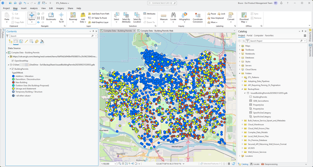

After sharing to your desired audience (OneDrive can add a shortcut to Windows Explorer's "My Files", this must be dragged into Pro's Folders leaf in the Catalog pane, you cannot browse for it), the experience they will enjoy is like this, geodatabase features and behavior in ArcGIS Pro.
