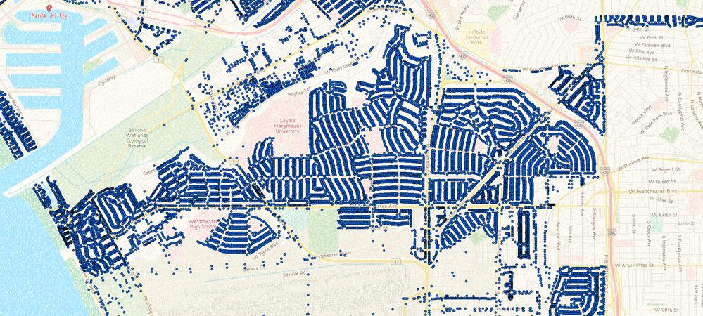

Los Angeles address pointsLos Angeles address points
The map shows the result of ETL into a hosted feature layer, which is my target information product.  It could also be any type of geodatabase.  The raw data is typical of many ETL sources, with these properties:

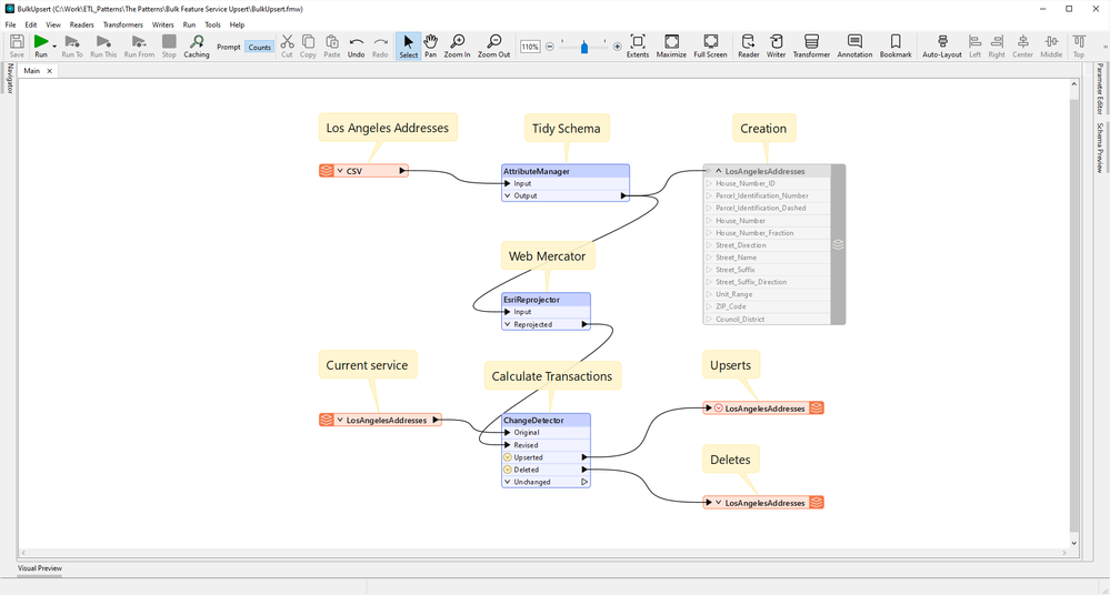

Upsert & Delete ETL ToolUpsert & Delete ETL Tool
This single ETL tool supports two stages in the lifecycle of my target information product:
  • Creation of the feature service
  • Applying updates to the feature service on demand
To create the feature service, the greyed-out writer labeled Creation would be enabled and the rest of the workspace would not exist.  After service creation I disabled this writer and added the rest of the workspace.  The workspace still reads the source CSV file at a public URL, but also reads the target feature service (which of course must already have been created), calculates the upsert and  delete transactions, and applies them.  It's a simple and powerful ETL tool but there is critical enabling work needed outside the ETL tool.

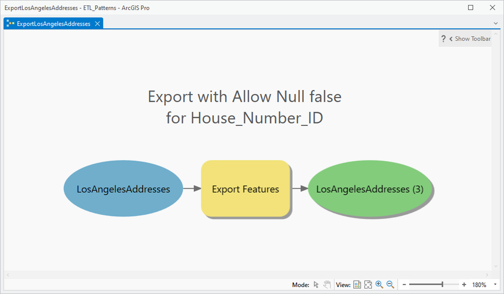

Meeting these conditions requires two simple processing steps outside the ETL tool before upsert processing will work.  In my ETL tool, there is no way to set these properties, and  there are two relevant factors:  The Alter Field geoprocessing tool does not support changing the allow nulls property for a feature layer field, but the Add Attribute Index geoprocessing tool does allow creating a unique index on a feature layer field.
To work around the allow nulls problem I exported the initial feature layer to my project default geodatabase using the Export Features tool and in the field map control unset the allow nulls property for the House_Number_ID field.
Export Features to GeodatabaseExport Features to Geodatabase
With the output feature class in Pro, I then created a map layer, taking the opportunity to apply symbology other than the pink lemonade default, then overwrote my target feature layer.

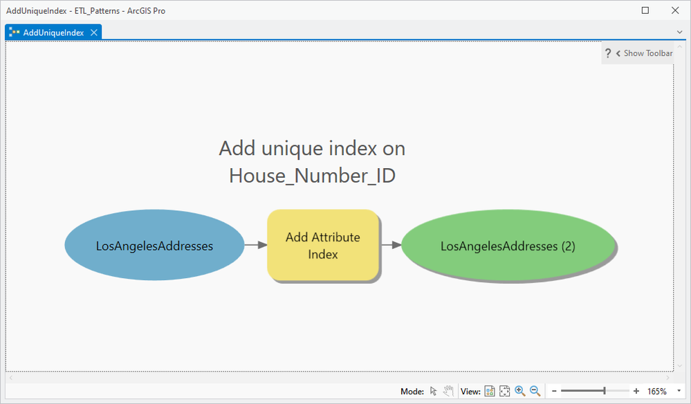

With the overwritten target layer, I then added a unique index for my match key field:
Add Unique IndexAdd Unique Index
Now the target layer is in shape for configuring upsert (and delete) processing!

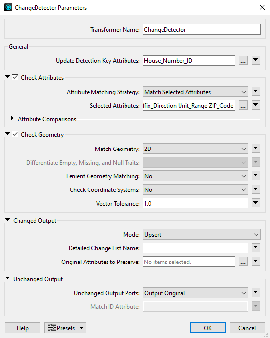

The ChangeDetector transformer is what generates the upsert and delete change sets.  Here are the settings:
Change Detector ParametersChange Detector Parameters

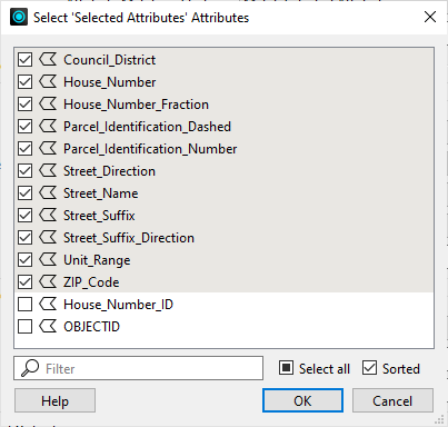

Using match attributes:
Detection FieldsDetection Fields
Change detection comes at the expense of reading the target features in addition to the source features but does deliver an optimally small edit payload.  For my subject matter data the whole job takes 5 minutes.

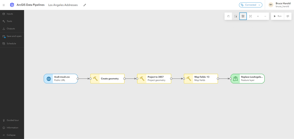

For completeness, I'll give a shout out to two other places upsert capability is offered in ArcGIS, namely the Append geoprocessing tool and  Data Pipelines Add and Update output option. However, if you need to delete features as well as upsert them, then in core geoprocessing you'll need to use Delete Features or Delete Rows or in Data Pipelines replace the output feature layer. This pipeline does that job for the feature layer my ETL tool operates on.
Data Pipeline Replacing Los Angeles AddressesData Pipeline Replacing Los Angeles Addresses
I'll take the opportunity here to call out that using Data Pipelines to maintain hosted feature layers in ArcGIS Online that were created by separate ETL processes is perfectly valid.  In my pipeline you'll see the Map Fields tool that greatly assists connecting the schema coming from a CSV file with how I defined the schema using Data Interoperability.
