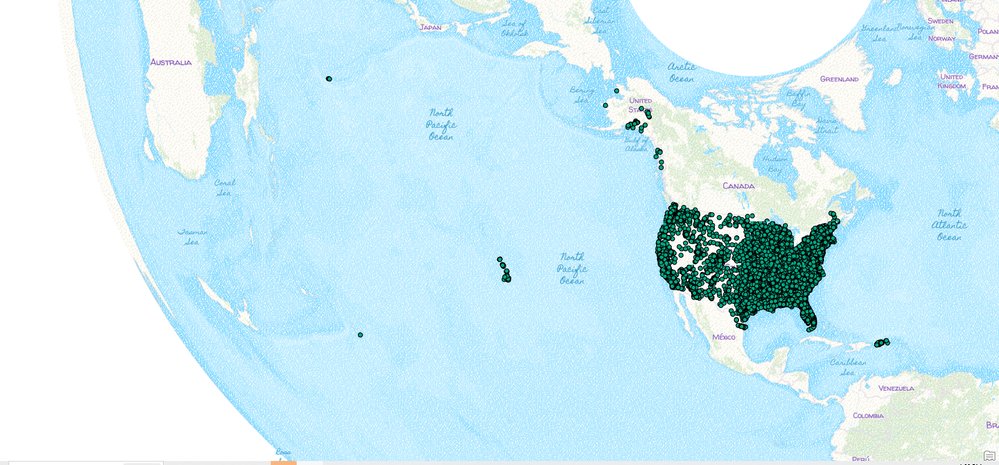

My subject matter data is Federal Communications Commission customer complaints data about unwanted calls, filtered for 2024.  If you want to see how it looks as incoming JSON click here for 1000 random records, but here's the end result as a feature service:
FCC Customer Complaints - unwanted callsFCC Customer Complaints - unwanted calls

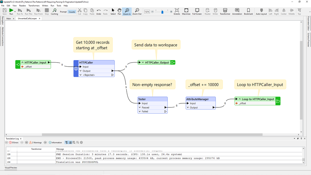

Pagination
We're calling a REST API here, and it offers a paginated response.  In ArcGIS Data Interoperability that means calling the HTTPCaller transformer in a loop, in this case with offset, limit and order parameters, incrementing the offset value each call, until all data is received and the response is an empty array.  You might not have known you can loop in a visual programming environment, but you can, and it's easy.  The mint green custom transformer "UnwantedCallsLooper" near top left in my workspace does the job.  It is a looping custom transformer.
Parent ETL workspaceParent ETL workspace
The custom transformer is embedded (included) in the Main canvas, it lives in its own eponymously named tab.  You create custom transformers by selecting one or more ordinary transformers in the Main canvas then a context menu accessible by right-click offers a custom transformer creation choice.  In my case I selected just a single HTTPCaller transformer.
After creating the custom transformer there were more editing steps to set up looping:
  • Add a loop return connection using a context menu choice in the canvas
  • Add a test for completion ahead of the loop return
  • Increment the offset parameter
Below is how my custom transformer looks.  At run time each feature arriving from the Main canvas has an offset attribute used by the HTTPCaller transformer.  The limit and order parameters do not change so are "hard coded" in the HTTPCaller.  The lower stream is the loop-until condition - if the response is not an empty array the data isn't exhausted, so increment the offset and loop!
Looping custom transformerLooping custom transformer

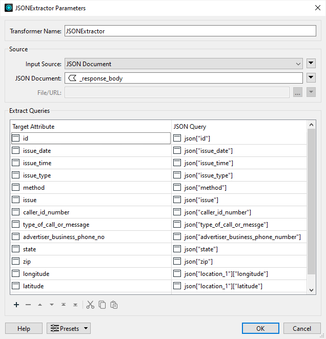

Now we parse each fragment feature with a JSONExtractor.
JSONExtractorJSONExtractor
The Extract Queries grid defines the output attribute names and where the data comes from in the fragment.  The JSON queries follow a simple syntax you can key in, but there is a simple trick to getting a picker to let you navigate the JSON structure and automate query generation.  Ahead of the JSONExtractor, temporarily sample a single feature and write it to a file, then temporarily set your JSONExtractor input source to this file and you'll get a handy picker for your queries!  When you have populated your extract queries remove the Sampler and reset your JSONFragmenter input source to be the document in _response_body.

A comment in LinkedIn prompts me to make clear what keeps the article's pagination approach simple.  You're usually expanding arrays returned from each API call but do not do this inside your looping custom transformer as then your loop continuation test might require sampling or counting features, both of which require blocking transformers, which will then require an externally linked custom transformer - much harder to manage.  I have made that mistake, and it put me off looping until I figured it out!  If you inspect the loop continuation test in the UpdateFS workspace you'll see I test if the response is JSON and does not match the regular expression \[\s*\].  The server returns "[ ]" (with a space) in the array, hence the regex allowing any number of spaces, including none.
