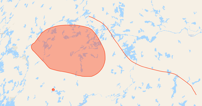

Below is the Notepad ++ for 3 features (point, line and polygon) with the "notes" from ArcGIS Explorer, for example "This is an area" as well as a snippet of what the features look like in the mapping area of the program. The projection is in WMAS:
{"version":"1.0","center":{"x":-10986870.271851821,"y":8242331.5418692939,"spatialReference":{"wkid":102100,"latestWkid":3857}},"scale":3354792.5980079924,"markup":
{"elements":[{"arrow":false,"geometry":{"paths":[[[-11220404.649048025,8150437.7533329763],[-11220213.247105539,8151177.2623707335],[-11219830.443220563,8152656.2804462491],[-11218908.231817715,8154126.5989443678],[-11217446.612896994,8155588.2178650908],[-11216341.699129056,8156319.0273254514],[-11215593.490513902,8156319.0273254514],[-11213200.960612934,8157980.7590058204],[-11209164.109426156,8161304.2223665603],[-11204379.03838446,8164436.2500655204],[-11198845.747487843,8167376.8421027008],[-11190554.533199845,8170691.5721667521],[-11179505.395520464,8174380.4402576713],[-11169013.075753514,8176964.3833408887],[-11159077.573898993,8178443.4014164042],[-11144896.408520654,8179365.6128192516],[-11126469.579618488,8179731.0175494328],[-11113758.721498501,8179539.6156069459],[-11106763.834160691,8178791.4069917919],[-11096271.503153976,8176946.9841860961],[-11082281.728478357,8174006.3471898586],[-11072702.909297094,8171248.4125587121],[-11067535.045610188,8168673.1802926548],[-11062932.676933579,8165358.4389888402],[-11058895.803267274,8161304.1886472683],[-11054110.732225576,8155779.6198075768],[-11048577.463808488,8148784.7324697673],[-11042313.397170804,8138840.5085583236],[-11035318.532312524,8125946.9480732465],[-11029611.272347506,8114715.1080287751],[-11025191.617275754,8105144.9884249084],[-11022424.983067211,8096671.0830115834],[-11021311.369721875,8089293.3917888002],[-11020754.563049208,8081002.1887405654],[-11020754.563049208,8071797.4738668799],[-11022598.985854905,8062044.6518979231],[-11026287.831466295,8051743.7228336958],[-11031264.30445048,8042904.4126901906],[-11037528.404807456,8035526.7214674074],[-11043418.378377328,8030002.1526277168],[-11048934.225160094,8026330.7061711177],[-11054093.366790075,8023390.0691748802],[-11058895.803267274,8021180.2416390041],[-11062210.544571087,8019883.9259285787],[-11064037.590701519,8019501.1220436059],[-11071397.894009273,8019309.720101119],[-11084291.45449435,8019309.720101119],[-11092399.955177495,8019866.5267737862],[-11095723.396058705,8020980.1401191205],[-11099412.230430331,8021719.6491568778],[-11103466.458292376,8022085.0538870599],[-11108808.324766979,8023555.3723851778],[-11115437.829854134,8026130.604651235],[-11126852.394743226,8029262.6435899585],[-11143052.019434249,8032951.4892013501],[-11154466.561843811,8035161.3054974629],[-11161096.021971913,8035892.0924782949],[-11169935.320875654,8037736.5152839907],[-11180984.458555033,8040694.5739145502],[-11187979.33465308,8042721.7103251005],[-11190919.94916979,8043817.9245156413],[-11193869.285743425,8045653.6477439404],[-11196827.344373982,8048228.8800099976],[-11201429.713050589,8053388.0441195071],[-11207676.391773246,8061131.1400724724],[-11212278.749210089,8066290.3041819818],[-11215236.785361117,8068865.5364480391],[-11222788.468131829,8076782.6464284612],[-11234933.797522228,8090041.6341232471],[-11241928.673620272,8097410.6145288693],[-11243773.096425969,8098889.5876453277],[-11245617.530471427,8100916.7015763493],[-11247461.975756651,8103491.9563219352],[-11248749.603129443,8105884.4974626657],[-11249480.412589803,8108094.3249985417],[-11249845.817319985,8111034.9619947793],[-11249845.817319985,8114706.4084513783],[-11248192.796456777,8118203.8521202831],[-11244886.754730359,8121527.2930014934],[-11242676.915954717,8123189.0134420991],[-11241563.280129857,8123189.0134420991],[-11241006.462217424,8123189.0134420991]]],"spatialReference":{"wkid":102100,"latestWkid":3857}},"color":0,"filled":true,"notes":"This is an area"},
{"arrow":false,"geometry":{"paths":[[[-11071597.995529156,8205700.8408846781],[-11070858.486491399,8205700.8408846781],[-11069379.468415882,8205700.8408846781],[-11066986.927275153,8205144.0342120109],[-11063680.863069206,8204030.4208666757],[-11059443.910362545,8202185.9980609799],[-11054276.069155166,8199610.7657949235],[-11050039.127688266,8197218.2471337207],[-11046733.085961848,8195008.4420773722],[-11043609.735360757,8193346.7216367666],[-11040669.07588499,8192233.0858119037],[-11036432.123178329,8189840.5446711732],[-11030898.877240771,8186169.0982145742],[-11025000.226573031,8181384.0384126408],[-11018736.171175111,8175485.3652653741],[-11013768.409008088,8169586.6921181064],[-11010096.940071961,8163688.0189708378],[-11006416.794037966,8158346.1524962373],[-11002727.970906101,8153561.0926943049],[-11000326.741427738,8149515.5419301288],[-10999213.105602875,8146209.50020371],[-10996081.055424387,8140684.9313640194],[-10990930.590892274,8132941.8354110559],[-10986510.93582052,8126860.4598986981],[-10982822.09020913,8122440.8048269451],[-10980064.166817747,8118577.9564278601],[-10978237.165646371,8115271.9147014422],[-10974557.019612376,8109930.0482268417],[-10969023.728715762,8102552.3570040585],[-10965708.987411946,8097758.5976247285],[-10964612.795700934,8095548.7700888524],[-10961115.363271791,8090763.710286919],[-10955216.690124525,8083403.4182189284],[-10949692.121284835,8077148.0399188763],[-10944541.65675272,8071997.5753867636],[-10940487.406411149,8068317.4293527678],[-10937529.370260119,8066107.6018168917],[-10930343.04726053,8062053.3514753198],[-10918928.437412381,8056154.6783280522],[-10910089.127268877,8052100.4167467151],[-10903825.116830012,8049890.5667313104],[-10889278.54672149,8045836.3163897386],[-10866449.41694331,8039937.6657219995],[-10850980.624192176,8036257.530927768],[-10842872.168468088,8034795.9120070469],[-10836608.090590641,8033882.388941831],[-10832188.39055983,8033516.9617321221],[-10824636.685309589,8032037.9436566066],[-10813952.974839916,8029445.3347152844],[-10806592.705251453,8027418.2207842628],[-10802555.876544204,8025956.6018635407],[-10792428.961507434,8019327.1192559116],[-10776211.960141145,8007529.7729613753],[-10764788.718154186,7998873.1651829602],[-10758159.235546557,7993357.2959206663],[-10754296.353428179,7990042.5546168527],[-10753200.071799055,7988928.9412715174],[-10750624.839532997,7984509.2974395286],[-10746570.656630009,7976783.6231208863],[-10743804.03366123,7972181.2544442788],[-10742324.970626658,7970702.191409708],[-10741585.439109372,7969597.2776417695],[-10741585.439109372,7968866.5131404651],[-10741220.05685872,7967761.6106122918],[-10740489.292357415,7966282.5700572468],[-10739567.092194332,7964812.2403193647],[-10738453.456369469,7963350.6213986427],[-10737713.947331712,7962619.8119382812],[-10737348.565081058,7962619.8119382812],[-10737165.873955732,7962619.8119382812]]],"spatialReference":{"wkid":102100,"latestWkid":3857}},"color":0,"filled":false,"notes":"This is a line"},
{"geometry":{"x":-11182071.973168179,"y":7978059.606098094,"spatialReference":{"wkid":102100,"latestWkid":3857}},"color":0,"notes":"This is a point"}],
"name":"Markup","version":"1.0"}}

GabElburn02
Hi Bruce,
I tried the EsriJSON reader and didn't get the result of each feature being extracted. I got one point shapefile that is all. It wasn't in the correct geographic location as well.
I just want a tool to read the .markup file, extract the features and then write each out as a point, line and polygon dependent on the content of said .markup file.
Do you know of any other program or script that can do this?
Thanks.
