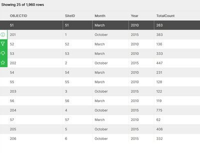

Unfortunately, the way your data is structured, it's not going to work like the example you linked to.
The reason that example works is because the data has a "Year" field and multiple years of data are represented by additional rows rather than columns.
Within a single indicator or chart, you can display multiple fields, but a category selector like that needs a single field to act on.

Thanks for your reply! I see what you mean. I had a feeling that was the problem. Do you suggest a solution if I wanted to recreate that linked map? Based off that example table, it seems like I would need a field with each station location, but it would be a repeat row for each year? For example in the bike count explorer, wouldn't a single bike point location have multiple rows since it has multiple years? Like this table would be an example.

Yes, if you wanted to replicate that other example, you'd need to restructure your data in the way you show.
And yes, that would create overlapping points. As long as you don't give an "all / none" option to your category filter, however, the dashboard itself will only show one year at a time based on the selected category.
