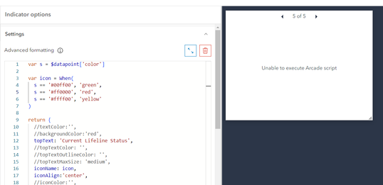

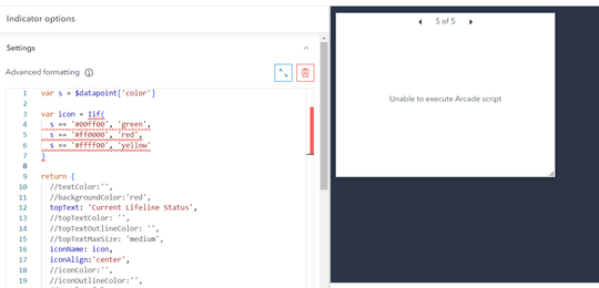

I need to return an icon based on an attribute value and I am not sure if I need to you when or Iif statement...or something else. I believe I need to change something in lines 3-7 but I am new to Advanced formatting with arcade. This is what I have tried:

Using When is fine, but you need a final "default value" that the function will return if none of the conditions are met.
var icon = When(
  condition1, 'this',
  condition2, 'that',
  condition3, 'the other',
  'something else'
Iif is for true/false situations, and can only return one of two values.
There's also Decode, which takes an input value and compares it against a list of other values, similar to what you're doing here. As with When, you need a final default value.
var icon = Decode(
  s,
  '#00ff00', 'green',
  '#ff0000', 'red',
  '#ffff00', 'yellow',
  'something else'
- Josh Carlson
