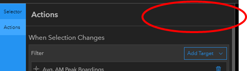

Hello,
I have a category selector configured in my dashboard that uses grouped values from a feature layer. However it appears that when using grouped values, the option to add an action to pan/zoom on the map in my dashboard is unavailable.
See screenshot below, usually there is an "add action" option in the red circle. Currently, I only have the ability to filter dashboard items.
Any ideas or workarounds? Thanks!
PanGIS
Hi!
Here are explained all the possible actions:
A selector with grouped values can only filter.
https://doc.arcgis.com/en/dashboards/create-and-share/configuring-actions-on-dashboard-elements.htm
