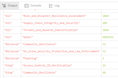

@KenBuja follow-up question to this data expression. If I wanted to return Jurisdictions = All, rather than the 6 total in this dataset. What's the best way to do that?
var fs = FeatureSetByPortalItem(
  Portal("https://www.arcgis.com/"),
  "384158f2ebe34f8ba8b0b39dfe5f5af5",
  0,
  ['Jurisdiction', 'core_capability', 'target_goal'],
  false
return Distinct(fs, ['Jurisdiction', 'core_capability', 'target_goal'])
KenBuja
MVP Esteemed Contributor
If I understand your question, the Filter function would do that.
dwold
that worked, thank you!
