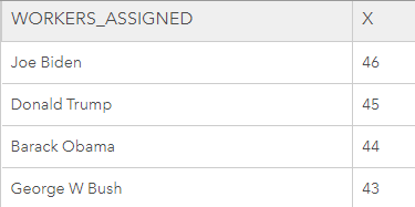

This is my test input
And the output it created
