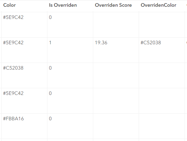

Hello - I would like to write an expression that will look at a field and return the values in a list. If that field is empty, look at another field and return those values in the field. Very green with arcade but I think this would be an if/else statement?
In my example, color will always have a value, overridden color will be empty 90% of the time. Would it be best to return color field first and if overridden has value return that value? Or overridden first then color?

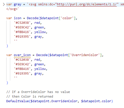

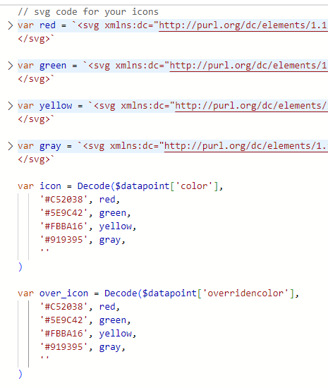

dwold
@jcarlson as always, thank you so much for your suggestion. That is exactly what I was looking for. After adding:
// If a OverrideColor has no value
// then Color is returned
DefaultValue($datapoint.OverridenColor, $datapoint.color)

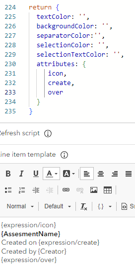

in the advanced formatting section, I assume I need to call that in the return section and line item template (both attached)?
Line item:
<table style="width:100%">
<tbody>
<tr>
<td>
<p><span style="color:#00c5ff"><strong>{AssesmentName}</strong></span></p>
<p>Created on&nbsp;{expression/create}</p>
<p>Created by<span style="color:#ffff00">&nbsp;{Creator}</span></p>
<p>{expression/over}</p>
</td>
<td>
<p>{expression/icon}</p>
</td>
</tr>
</tbody>
</table>
jcarlson
MVP Alum
You'll need to assign the output of the DefaultValue statement to a variable, then use that in the appropriate location.
var rendered_color = DefaultValue($datapoint.OverridenColor, $datapoint.color)
return {
  attributes: {
    rendered_color
Then call {expression/rendered_color} in your line item template wherever you want the color / override to be applied.
