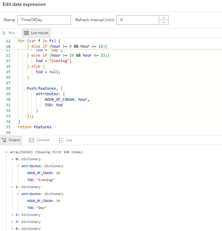

Hi!  I'm trying to build a data expression in an ArcGIS Online dashboard that will take a field called, HOUR_OF_CRASH, which is an integer field and not a time field, and populate a new field called, TOD, which will be a text field for the time of day the hour falls within so that the new field can be used to build a pie chart within the dashboard.  The current data expression is shown below.

Unfortunately, this data expression won't function within the dashboard and doesn't give me quite the output I am looking for in the end.  See the below image of the output.

Hi @Bec,
So the issue is that you are not returning a feature. When creating a custom data expression you should return a value similar to the one below.

Yes, RPGIS, your input about returning a FeatureSet was valuable in helping me get to my final output.  I made a few more adjustments to the final data expression and what you see below is the working version along with an image of the output.
