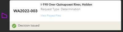

The list item looks great, however the URL being created in the list element is incorrect - it actually just changes the URL to that of the Dashboard for each item in the list.

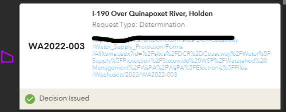

If I change my data expression (line 1 only - the return statement in line 20 remains the same)  to the following, then the link is correct and works.
var link = $datapoint["Project_Folder_URL"];
The issue here is that this is what my list element looks like:
Help understanding why the Iif & IsEmpty statements return the Dashboard URL instead of my project URL would be appreciated.
