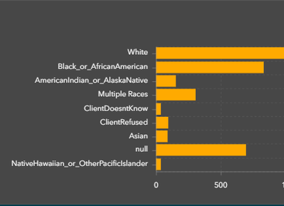

Hello, I require assistance regarding the addition of the second field.
Currently, I have race and ethnicity fields that need to be displayed together in a serial chart. I have successfully managed to segregate the data based on race, as that particular question allows for multiple choices from different races. I aimed to obtain individual counts for each race while also considering the cases where respondents select multiple races. However, I am unsure of how to incorporate the Hispanic/Latino category from my ethnicity question on the list. Despite it seemingly being a simple task, I have been unable to generate any ideas on how to achieve this.
I sincerely appreciate any help you can offer.
This is what i have so far:

And this is the graph i can get from that.
