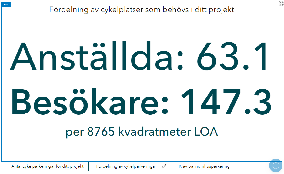

I have a dashboard that uses multiplte indicators based on arcade. Some of my indicators have a title, toptext, middletext and a bottomtext. The toptext and middletext are formated in the same way. My issue is that the middletext always look bold in comparison to the toptext. The font size looks right, but there is always a slight difference between the two. See picture below.
Does anyone know why this is and if there is a solution to my problem? Thanks!

The center line in the indicator has its own CSS class: .responsive-text.indicator-center-text, which has this:
font-weight: var(--calcite-font-weight-bold);
Other indicator lines (top / bottom) have their own corresponding classes, in which the font weight changes. So the middle line will always be bolder than the others.
