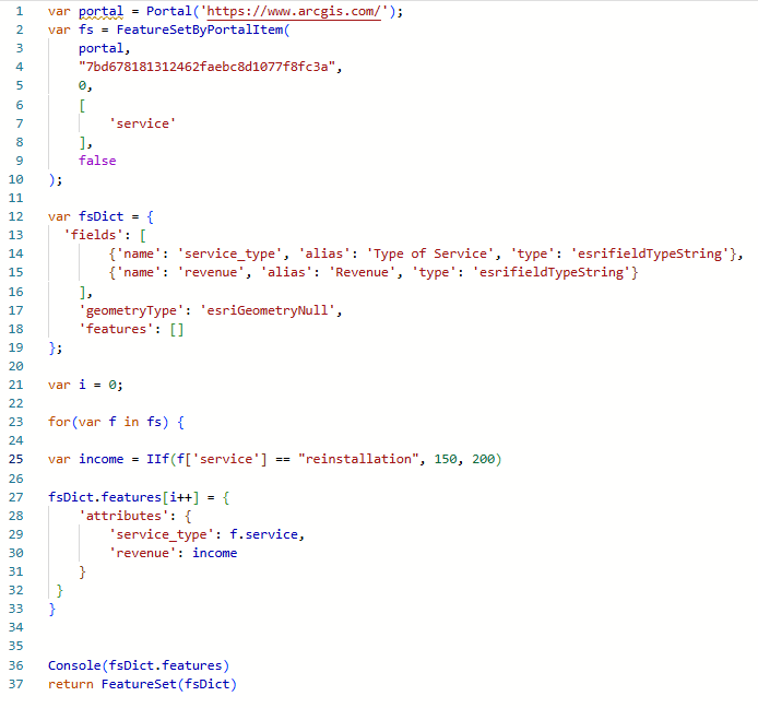

Hello,
I'm trying to create a feature set as the source for a table element, but my data expression gives the following error: 'Test execution error: Unknown Error. Verify test data.' I would greatly appreciate any help available. I'm very new to Arcade.
KenBuja
MVP Esteemed Contributor
Your error comes from lines 14 and 15, where you need "esriFieldTypeString" instead of "esrifieldTypeString". Case matters!

Can you post this as code instead of an image? It's easier to do checking when we can copy the code to the Playground
PlANNADMIN
Thank you so much for responding. The code is below:

KenBuja

PlANNADMIN
Thank you so much! It works perfectly now. I really appreciate your help.
