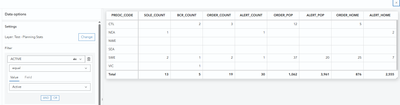

Without filter:
With filter:
The summary in table elements is not respecting the filter set in the data options, and is including sums and counts from all records in the underlying attribute table.

That's correct. This was captured in BUG-000185817 which was fixed in a recent update.

Hi @Michael_Dykes I was not able to reproduce this  using my own Dashboard. I encourage you to connect with our Support team so we can take a closer look at the fields and configuration. https://support.esri.com/en-us/overview
CMSchelde
This issue seems to be resolved on my Dashboards on Tuesday 30 July 2026 in the morning, it was not working correctly as of Monday 29 July 2026 in the evening CET.
