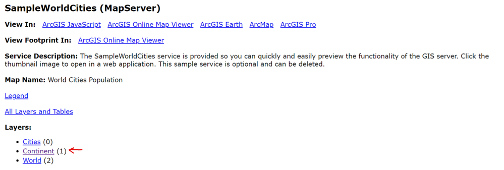

Hello Melanie,
Could you try adding the table as a Map Service Layer in your portal's contents and add the layer to the dashboard?
Map Service:
Map Service Layer:
