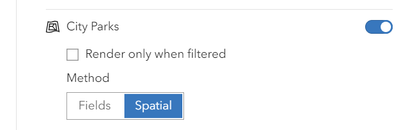

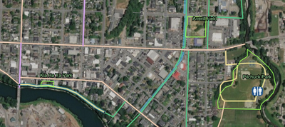

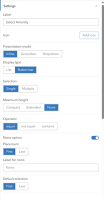

I'm having a similar issue. When making a spatial filter I am getting more outputs than I should. An example below is that I'm trying to filter public parks by which one has a bathroom. Instead of just showing me the one that contains a bathroom, it includes other parks. How do I change the spatial filter to not include the unwanted shape files that do not spatially intersect with the amenity?
