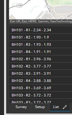

At the moment I can only get the Dashboard to show each visit as a new line in either the table or list. Is it possible to show this data summarised, so that just 1 line exists for each borehole? And then show the different depths recorded, and use an expression to highlight/pull out the min/max?

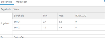

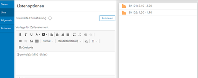

You can use the GroupBy function for that:
var test_data = {
    geometryType: "",
    fields: [
        {name: "Borehole", type: "esriFieldTypeString"},
        {name: "Visit", type: "esriFieldTypeString"},
        {name: "WaterLevel", type: "esriFieldTypeDouble"},
    features: [
        {attributes: {Borehole: "BH101", Visit: "R1", WaterLevel: 2.6}},
        {attributes: {Borehole: "BH101", Visit: "R2", WaterLevel: 2.4}},
        {attributes: {Borehole: "BH101", Visit: "R3", WaterLevel: 3.2}},
        {attributes: {Borehole: "BH101", Visit: "R4", WaterLevel: 2.5}},
        {attributes: {Borehole: "BH101", Visit: "R5", WaterLevel: 3.2}},
        {attributes: {Borehole: "BH101", Visit: "R6", WaterLevel: 2.9}},
        {attributes: {Borehole: "BH102", Visit: "R1", WaterLevel: 1.8}},
        {attributes: {Borehole: "BH102", Visit: "R2", WaterLevel: 1.6}},
        {attributes: {Borehole: "BH102", Visit: "R3", WaterLevel: 1.6}},
        {attributes: {Borehole: "BH102", Visit: "R4", WaterLevel: 1.3}},
        {attributes: {Borehole: "BH102", Visit: "R5", WaterLevel: 1.9}},
        {attributes: {Borehole: "BH102", Visit: "R6", WaterLevel: 1.5}},
var boreholes = FeatureSet(Text(test_data))
//return boreholes
var range_statistics = [
        expression: "WaterLevel",
        statistic: "MIN"
        statistic: "MAX"
var boreholes_with_range = GroupBy(boreholes, "Borehole", range_statistics)
return boreholes_with_range
