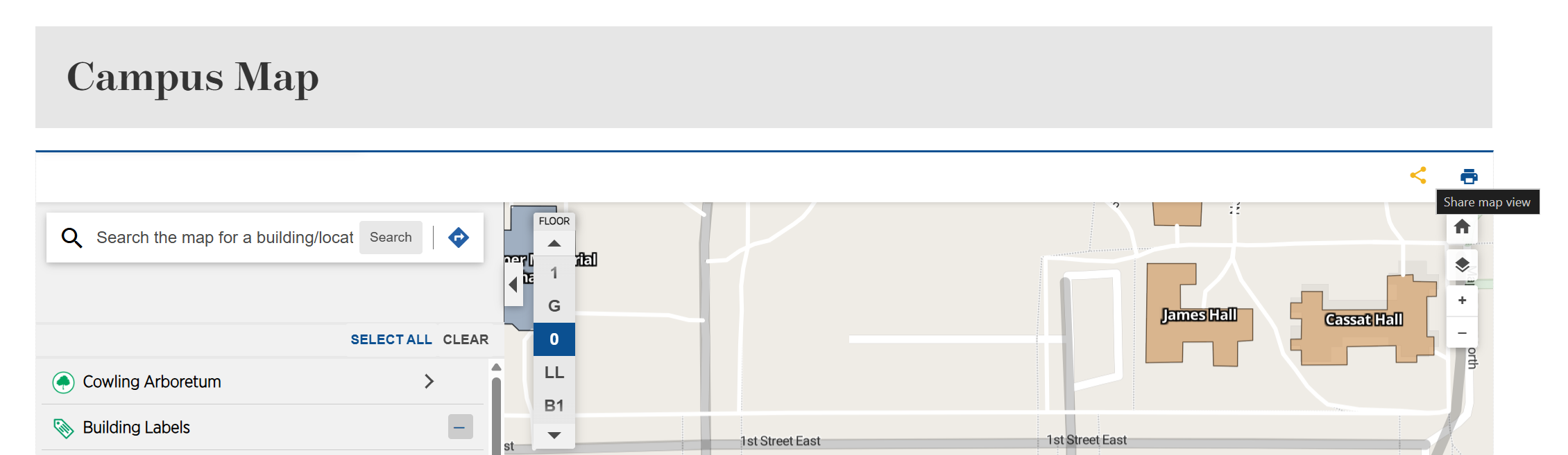

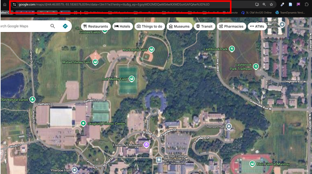

Does anyone know if there is a way in ArcGIS Dashboards for users to be able to zoom in/out and share that specific view?
For example, in Google Maps, I can zoom into a specific view, and that URL links to the specific view -
In this Concept3D version, they can share the map view, versus just the app
