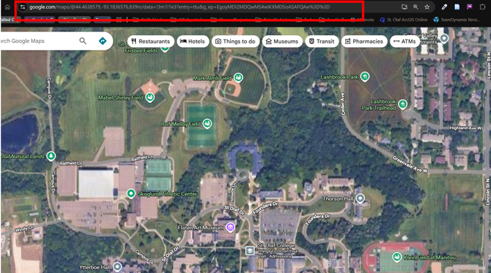

Does anyone know if there is a way in ArcGIS Dashboards for users to be able to zoom in/out and share that specific view?
For example, in Google Maps, I can zoom into a specific view, and that URL links to the specific view -

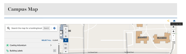

In this Concept3D version, they can share the map view, versus just the app

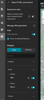

This made me revisit the workflow—there may be a better option. One approach is using a List widget so clicking a park automatically zooms to it in the live app, and then sharing from that state so the selection persists.
Another option is enabling URL data selection parameters. That way, when a feature is selected and zoomed to in the live map, the copied URL can reproduce that same selection and view.

I was hoping to replicate this in Dashboards the same way I did in EXB. Support was able to reproduce my issue: the zoom-to and pan capabilities that should work in 11.2 and 12.0 are not functioning as expected. They are logging a bug, since the documentation states that you should be able to zoom to a location from a table widget, but currently you can’t. I was hoping to click on the map, have it zoom to my point, and copy the URL—something I was able to do in EXB. Going to try to log an enhancement/bug for that as well.
The zoom-to action currently works within the list widget; however, even when a specific point is selected and zoomed to, the URL does not update. As a result, copying and pasting the URL will not preserve the zoomed-in view.
