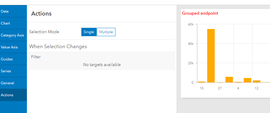

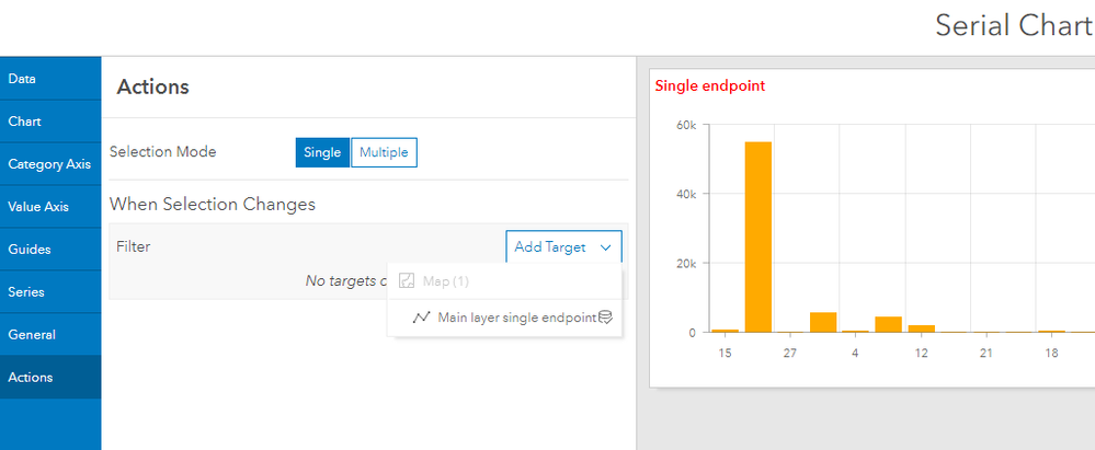

Hi @JohnSolly4 - Enterprise 10.8.1 here.
Is one of the known limitations with "grouped" rest service endpoints? I can't seem to get the Filter Map option for the map when using the service URL of
https://maps.example.gov/arcgis/rest/services/Example/Utilities_Example/MapServer
but I can if I use the single endpoint URL in the map..
https://maps.example.gov/arcgis/rest/services/Example/Utilities_Example/MapServer/4
If it is not the group, is there something else causing it?
Thank you
